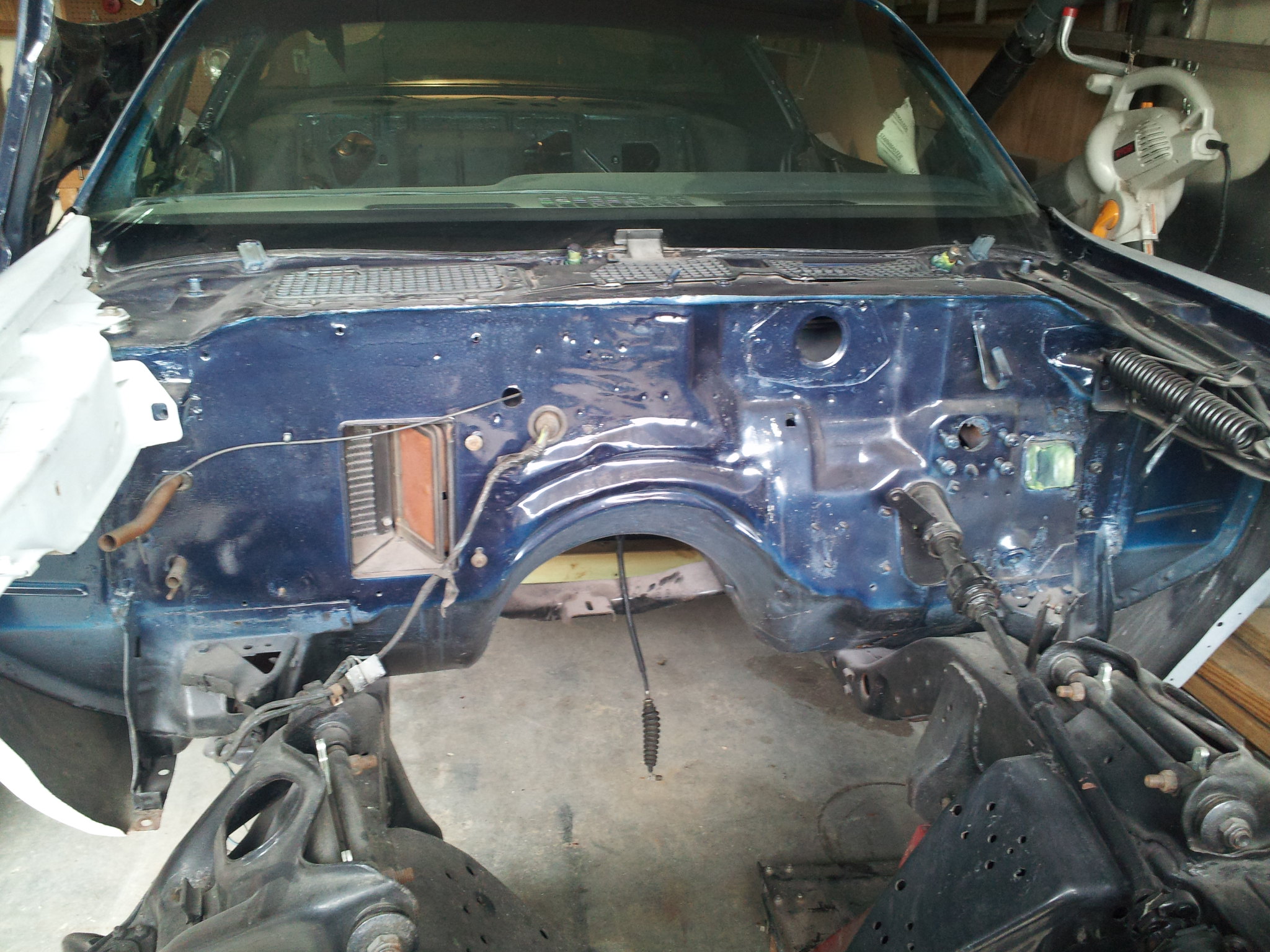

And now the '72 has been sidetracked by this car. The more I looked at the previous owner's repairs, the more I felt like I should just sell or part the car. Instead I decided to fix it. The PO managed to install the engine at an angle and askew. I know the engine should be offset to the car's center-line, but this something you'd have to see. I'm really surprised there wasn't any odd vibrations. The motor mounts were trashed and welded in. The rad support was rotted beyond repair. There's some collision damage to the bumper plate. The toe panels, forward floor, rear floor, and rear seat panel on both sides had huge rot holes with repair panels welded on top and slathered in ROOFING CEMENT! The wrong body bushings were installed in rotted out holes; this is the most surprising problem because I drove the car that way for almost 2 years in an extremely dangerous state without a clue to how bad things were.
So far, I replaced all the rot on the floor pans. I had to smooth the firewall because the PO bolted a remote oil filter through the gutter; it caused massive rot to the heater area. The upper cowl needed to be replaced and I had to fab windshield braces. All the body mounts and drivers forward torque box have been repaired and all the caged nuts have been re-caged. Thankfully the rockers are good! Next up is to replace the rear torque boxes.

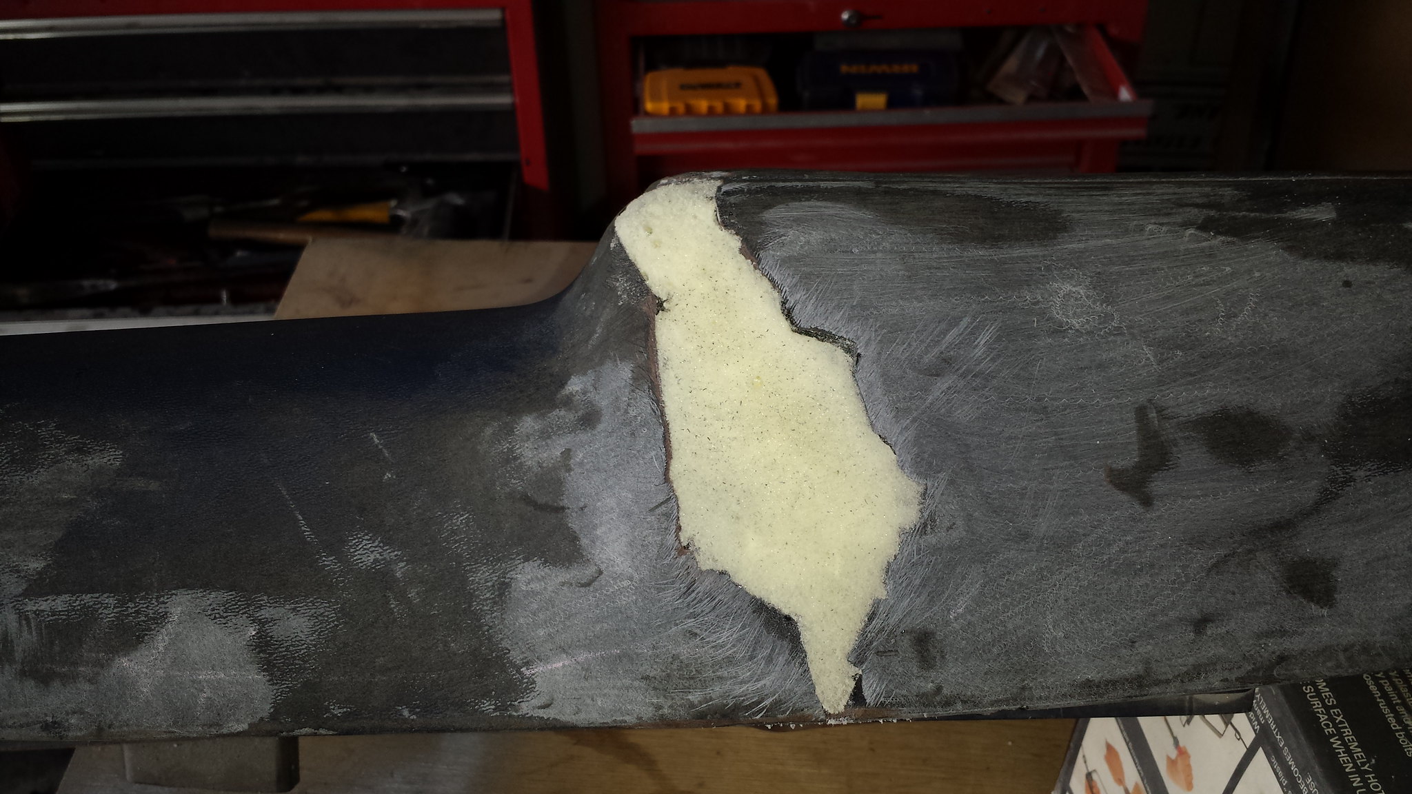

Got a Hazard Fraught plasma cutter today. I used it to cut a patch out of 16ga. My origional plan was to make the patch in 2 pieces, but I was able to cut this odd shape using the plasma cutter and a template. Plasma is a dream compared to using an angle or die grinder.
« Last Edit: June 13, 2021, 10:14:38 PM by Ford5of5 »

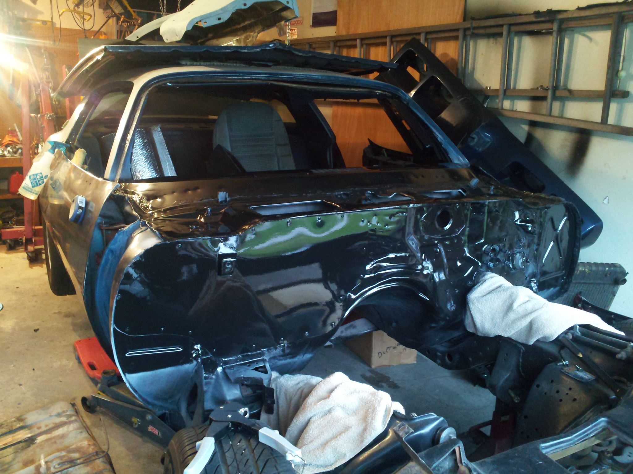

Trunks patches, rear frame rail segment replacement, and finished inner and outer tail panels
Here's the replacement frame rail section that i got off of Ebay, manufacturer unknown. In regards to this particular piece, I will yield to my friend Doright. The fitment was horrible and required a lot of cutting, banging and rewelding.
The AMD inner and outer tail panels fit like a glove. By accident, I bought two different manufacturer's inner panels. One was AMD and I think the other was Goodmark. Both AMD panels had crisper profiles, all the holes were either dead on or very close and pretty much fell into place.
The trunk closed on the first try. YAY!
