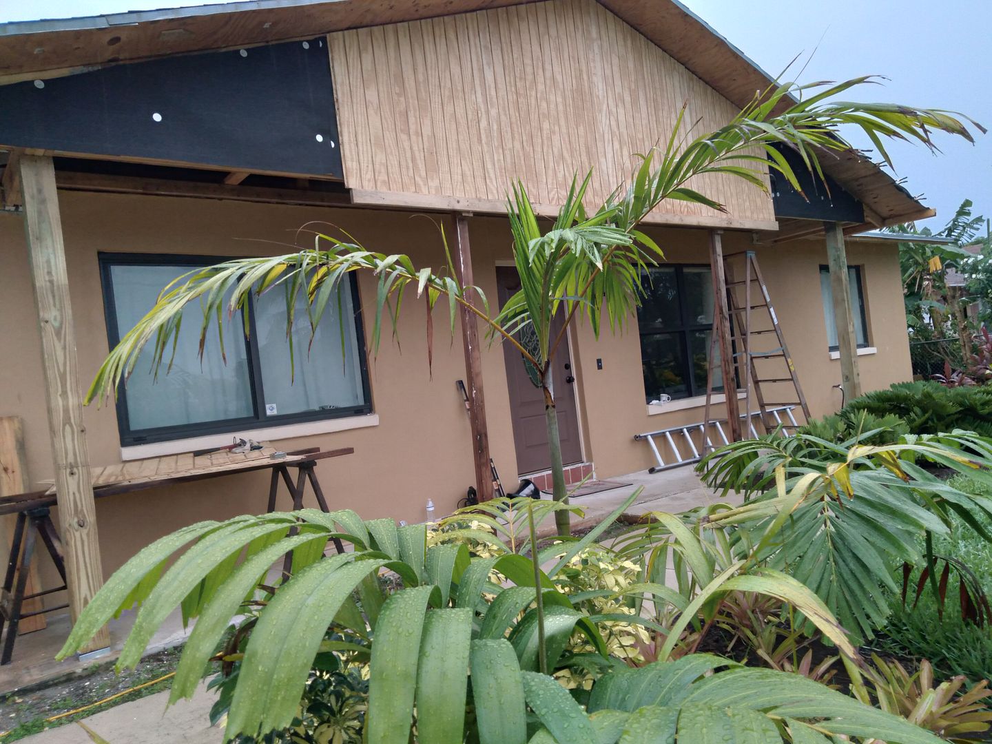

This front section is the last part of the project. I did the back first (no siding) then the South end next which has siding. I only intended on replacing the two center sections of the T 1-11 (which had some rot) and figured I'd scrape & sand the remaining sections. After buying siding and tearing it apart I decided I'd just replace all of the siding. Since I'd already bought the T 1-11 I just continued with it. It'll last longer than I will.
I built new 2 X 4 framework for the soffits on the gable and started installing the 3/8" ply in the soffits.  Haven't been able to source the aluminum H channel I need that fits between the plywood sections as support & molding.  When previous repairs were done they threw away some of the pieces here and there so I've been robbing Peter to pay Paul reusing the old moldings after scraping/sanding as I worked around the house figuring I'd find new molding by the time I was ready to finish the front, but no dice.  If anyone knows where I can buy it please let me know.  I keep cutting panels and tacking in place but can't nail till I find the molding.  HD, Lowes, Ace, McMaster, don't have in stock at stores or for shipment and I've emailed the companies I found that make it but no reply.
EDIT: Yes Kerry, I'm leaving a small gap where the vapor barrier drops so any water that might find it's way through the siding seams can drain. I know you'd wonder if I knew (or remembered) to do that.
 Here's where I'm at now and a pic of the H molding.
