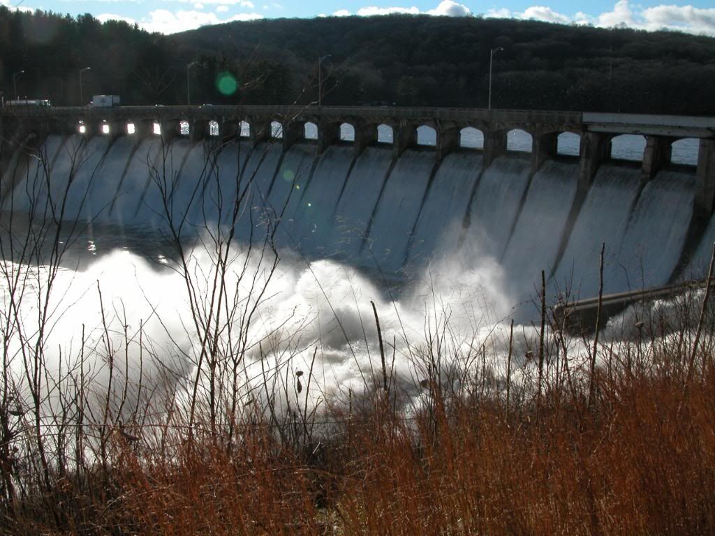

People might wonder why systems like this are required sometimes. Might have to do with where the run off ends up far away from the construction site.
I lived on a river below a large dam. The dam was built in the early 1900's. Over time as more roads, sidewalks, buildings, driveways, etc. were built for hundreds of miles along the river and it's tributaries the runoff kept increasing. It got to the point where there would be 6-8 feet of water in the yard during floods. Flood damage was devastating once flooding got up into the first floor area. FEMA want's to remove the homes.
The last time it flooded when I lived there they forgot to tell us to evacuate because they were going to open the flood gates. Firemen with a huge swamp buggy ventured out to tell us in the middle of the night when freezing cold water was already waist deep in the yard. Fun times hiking to the buggy in pitch black surrounded by waist deep rushing river water. Force of the water flipped cars that didn't get moved because owners weren't notified of flood gate opening on a couple occasions. LOTS of water!
Waters about 5' deep in the yard in pic below. Highest it got when I was there was about 2' above the deck.
