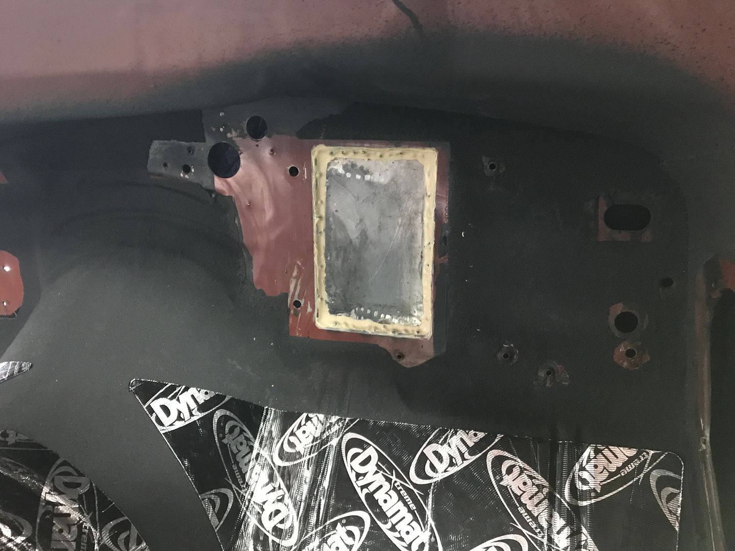

I also made a plate to cover the outside A/C box opening. I just cut a piece of sheet metal and tack welded in. I applied seam sealer around the outside and inside. Although I didn't make that panel area completely flat, the cover does make it look a little cleaner in appearance.

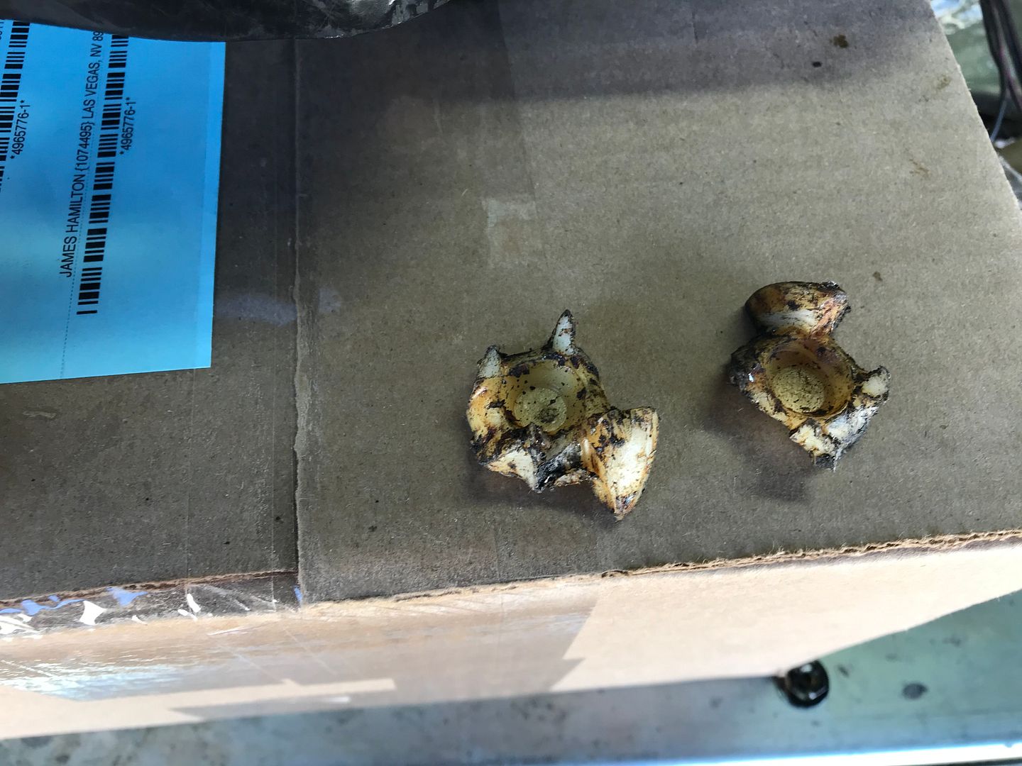

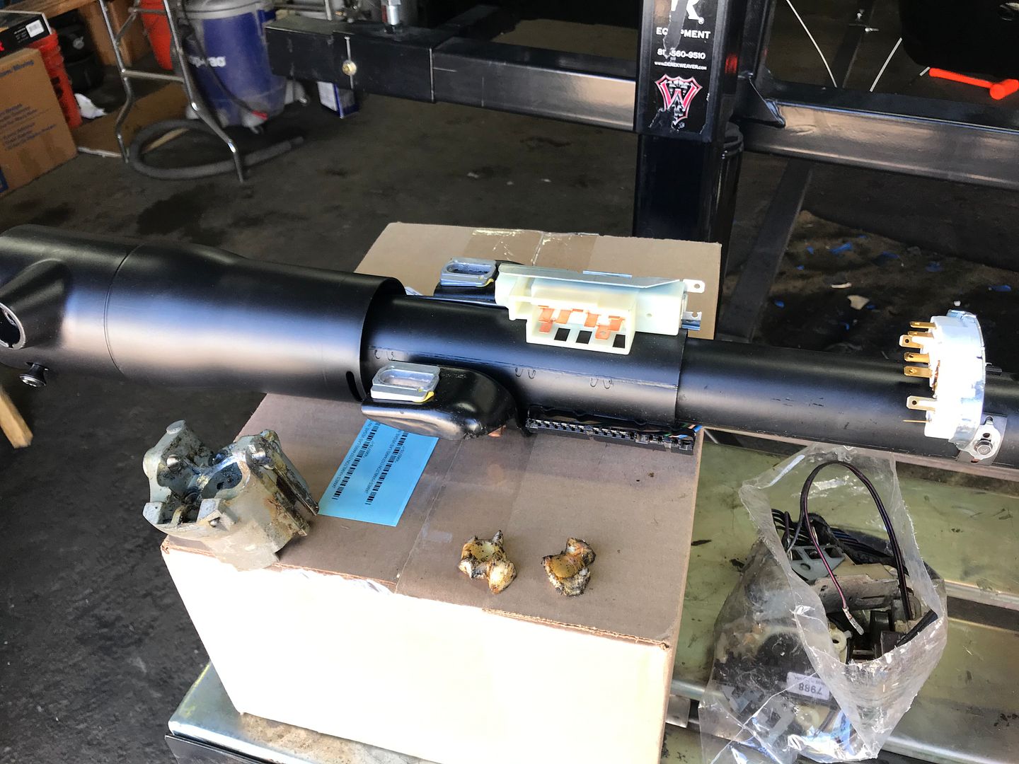

Last week I sent out the original steering column to have it refurbished. Internally the steering column had some real issues, it kept binding up. It turned out the ball joint was cracked and broken. As well as some other issues that were addressed the column arrived back to me on Monday and I was really happy with the results.
The company that did the work was Steering Column Services. The are located in Albuquerque New Mexico. They did a fantastic job on the column and were more than outstanding in customer service, needless to say the turn around time was exceptional. My column was pretty thrashed, but when it came back it looked like new. Pretty much all of the internals were replaced and I was very happy with it. Considering the amount of work the cost were fairly reasonable. All said and done it was still cheaper (about $200 less) than replacing the column. They also sell parts for columns and can offer great technical support too.

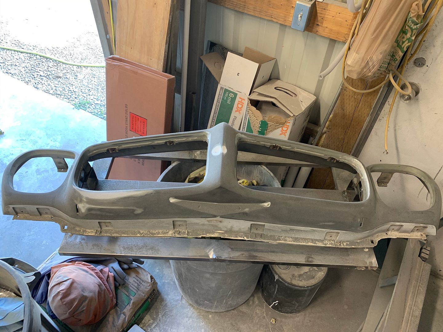

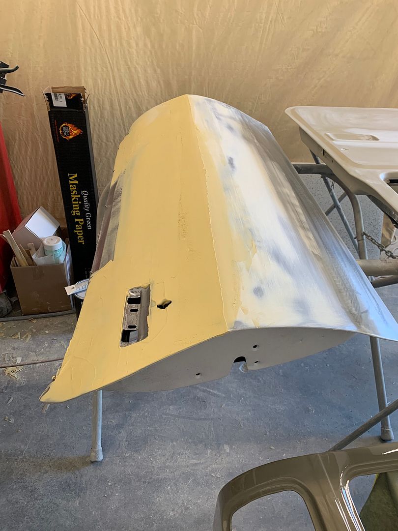

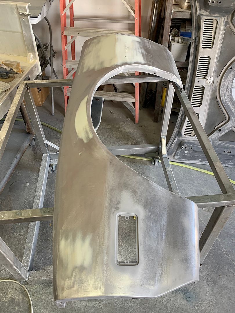

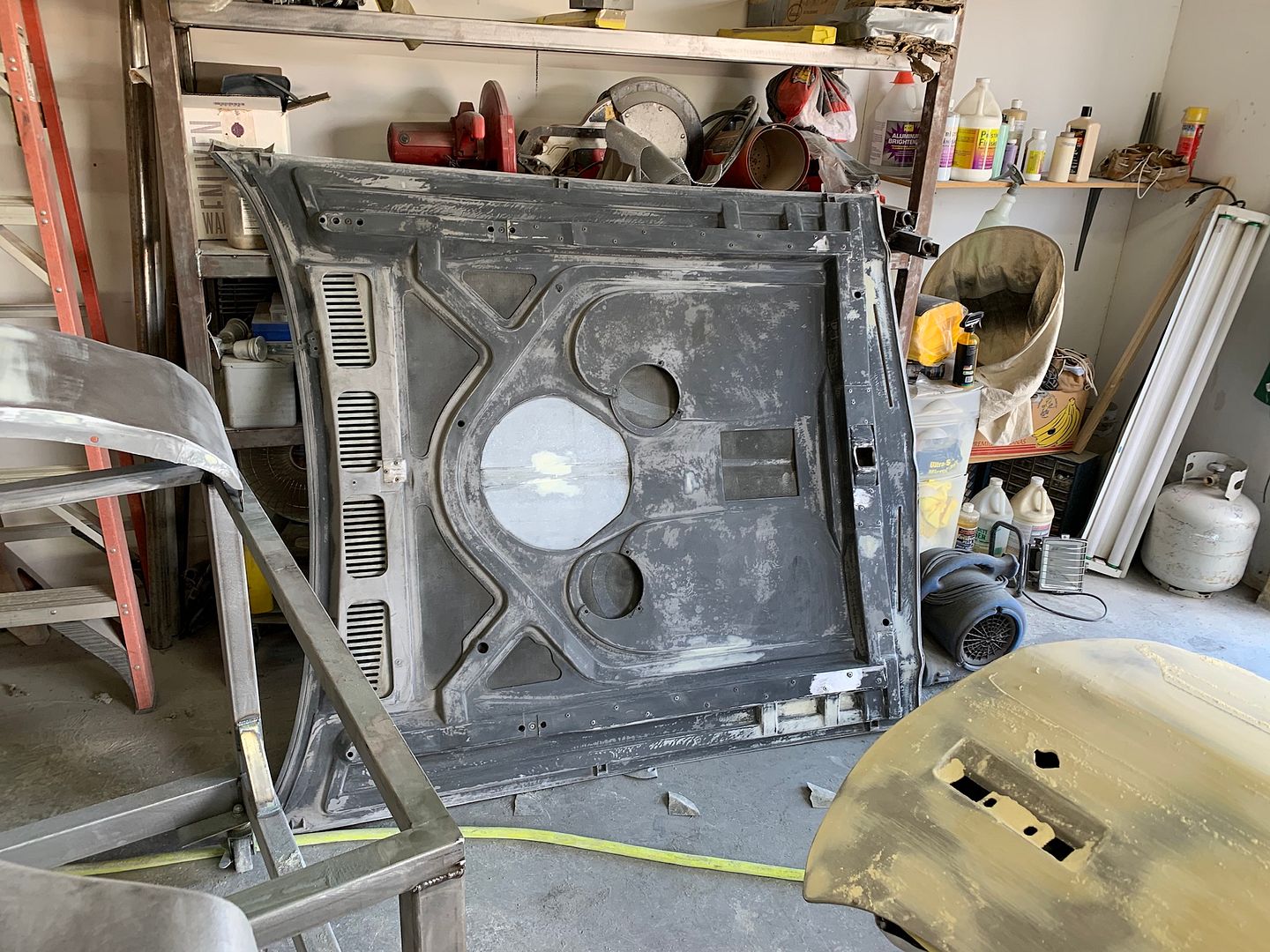

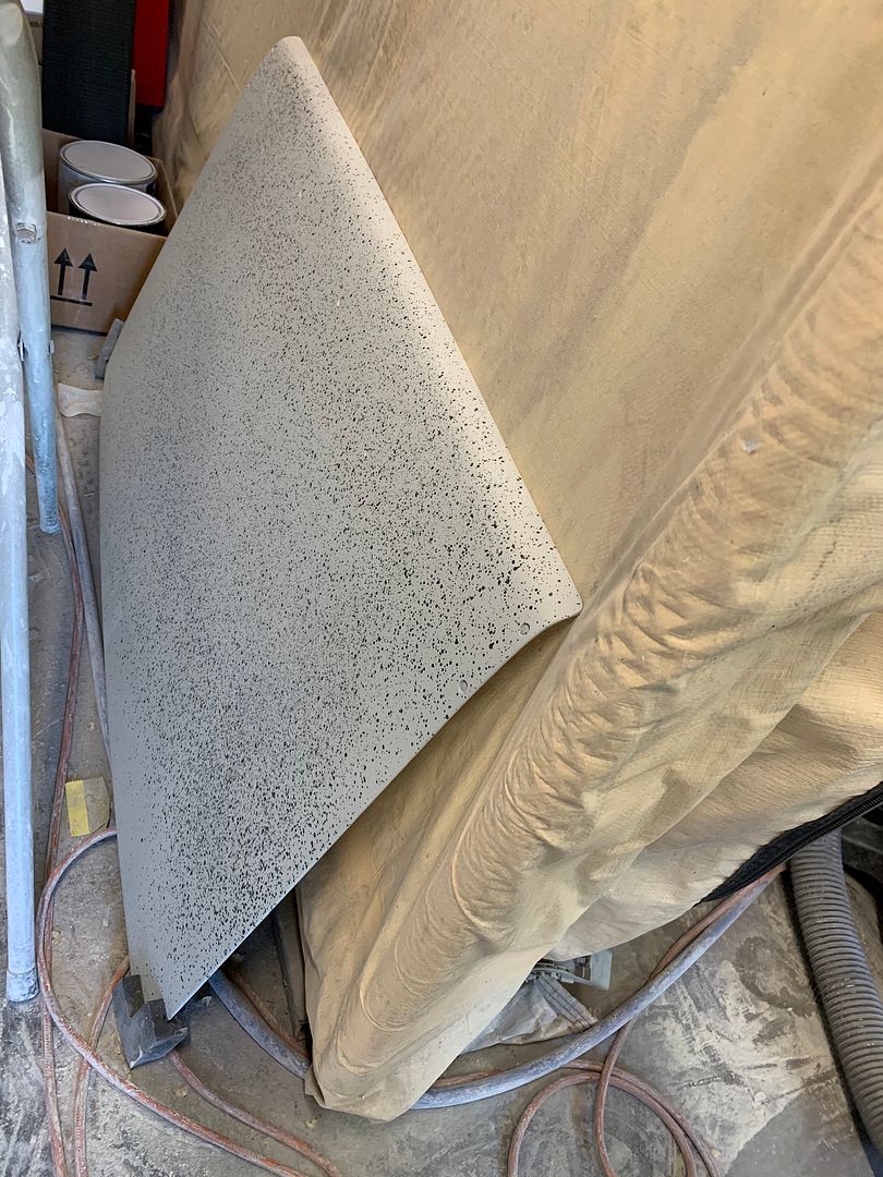

I got a paint and bodywork update this week as well, I have most of the external bodywork and pieces being worked on right now. The good news is that my paint guy is doing a pretty good job. He sanded the endura bumper down to the substrate and we were trying to reference some material on painting techniques for the bumper. I found a few reference on PY forums and forwarded it to him. I am hoping by the end of next week I will have the body back to roller status so I can send it to him for paint.

I later put on the steering column, intermediate shaft and the steering linkages. I put a set of 14" Rally rims I had as a spare set. I was very happy to get the car into roller status. I bled the brakes and that went pretty well, no leaks, good pressure. I also had to install the new brake and clutch pedal. I am swapping out the automatic transmission for a manual 5 speed. I went with the TKO600 with .64 overdrive. The transmission showed up this week and I am really looking forward to the swap.
Last week I put the car on a trailer and took it for bodywork and primer. The door jambs, sills and other areas will be painted with color, but mostly the car will be in primer. Once I get it back I will install the drivetrain body panels and electrical. After that it will go back for final paint.
It will be in bodywork for about 4 weeks and that has given me some time to do some late spring cleaning to my shop. I have a few other minor projects I plan on doing in the meantime. However I am really excited about installing the drivetrain and electrical and seeing the car come back to life!

« Reply #102 on: June 26, 2020, 01:07:22 AM »
Got some pics today from the body shop. So far the process is going well and good. Hoping that the week after next I’ll be putting body panels and drivetrain back in.
