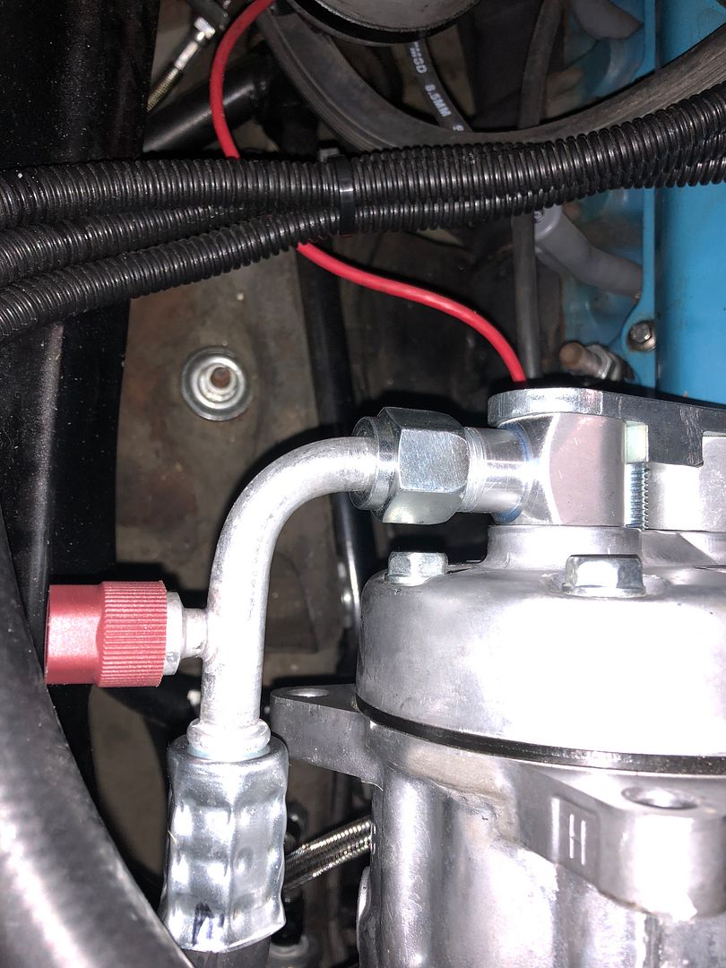

Decided to try out the Sanden Modification.  Seen a few cars with the Vintage Air set up, but did not want to do all that work just for a modern compressor.  My A/C system was complete, but really like the way this modification cleans up the engine on the Olds 403. Considering the A6 takes up a lot of room on the Olds 403 I decided to figure it out.  Plus now I can actually see my passenger side and get to the spark plugs.  If I ever run headers again sure makes it easy now.

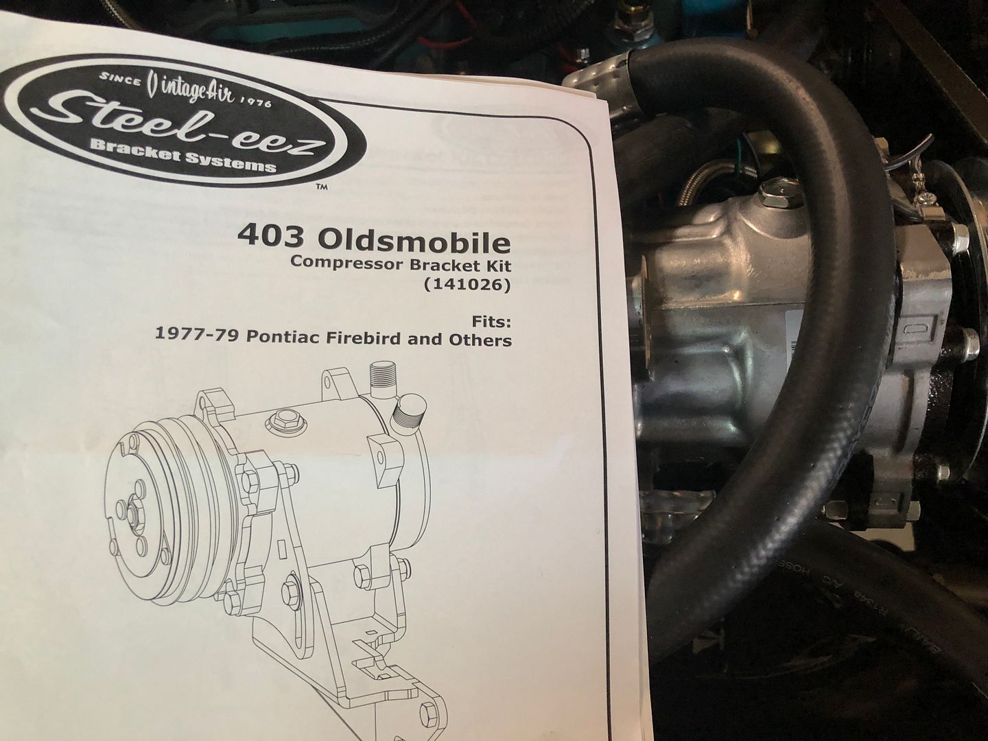

Hard part was the bracket and getting all the fittings.  First bracket did not work out as that one was for a Vintage air with Olds 350.  The Olds 403 has different brackets so that took time to figure out and looked at all the installation manuals for the complete kit and figure out how to do compressor and lines only.
Start with 4860 FLX7 Sanden Compressor - this is the newer 7 cylinder one.  Not the cheapo 5 and 6 cylinder
Vintage Air Bracket - Hard to find - Summit Racing - special order  - 1401026
Universal A/C Compressor Swivel Manifold - Ebay
AC Adapter Harness A6 to FLX7 -Harness Assembly Sanden  02-3140   truckerac.com

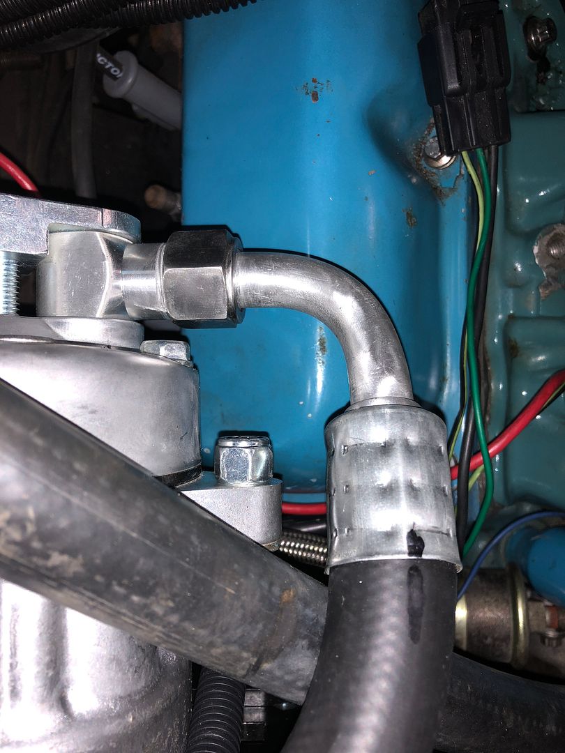

Barrier Hose
Fittings.  This was a bit of trial and error.  I probably spent $100 in fittings and hose getting all the right ones.  There is one that is special and you have to go down from #12 to #10 on the compressor.  I can probably figure out all the fittings used.  Better yet you spend the money and learn like I did.
Hydraulic hose crimper - If you send me your lines and mark them - can crimp them.  You just have to cover the shipping and $25.00 for my time.
I think it really looks good and cleans things up.
