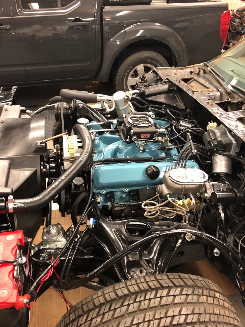

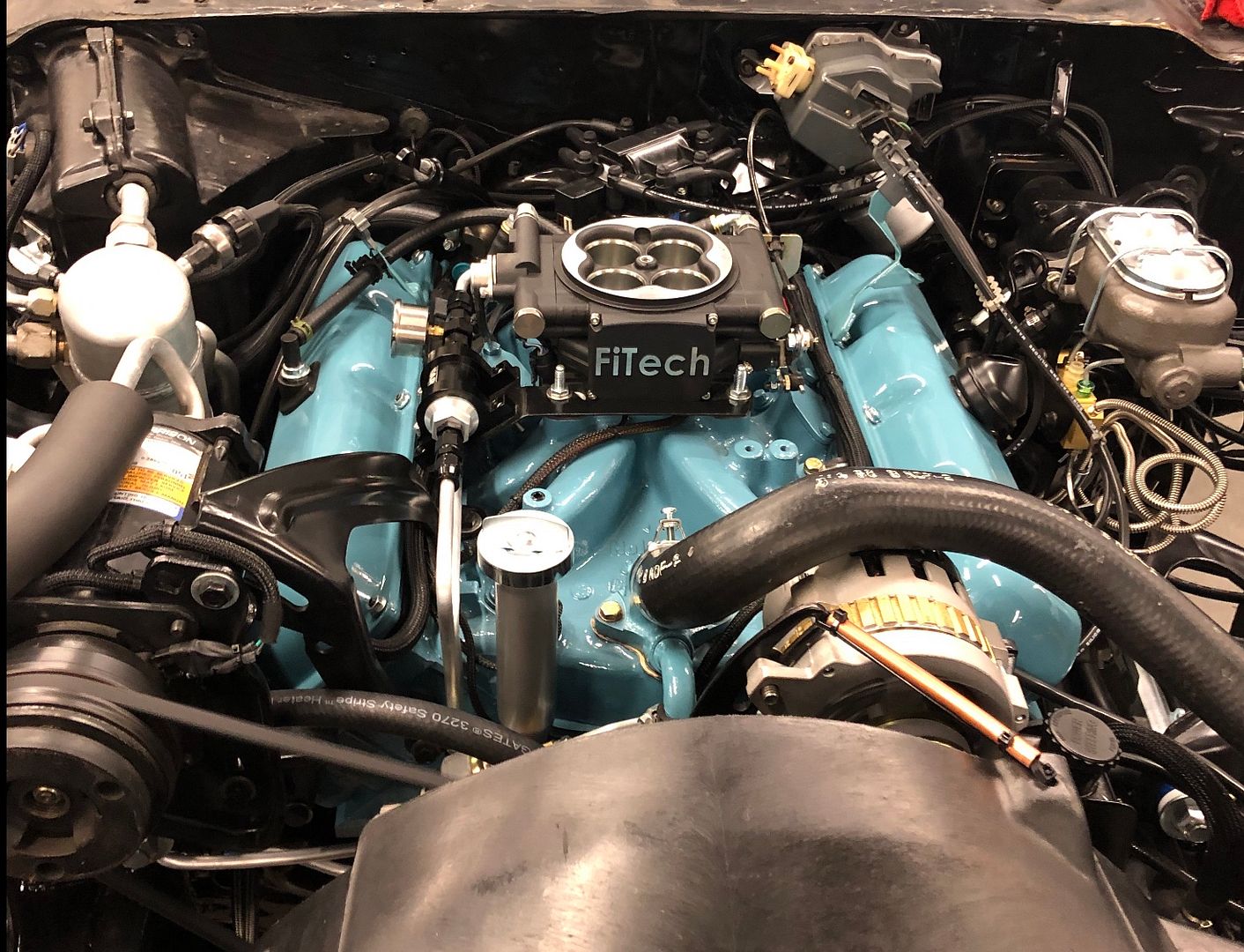

« Reply #45 on: February 10, 2019, 05:24:01 PM »
It is Alive Feb 10, 2019
The expression on my Dad's face was worth the 18 months of hard work that everyone all put into this day.
Would not have been possible without the help of the following:
My wife - thought she would have killed me by now. The countless trips to the machine shop, fed ex, ups, and phone calls.  Trips to the shop some 45 mins each way.
My brother - for all the help along the way.
My dad - who pulled this all together after 25 yrs.
Restoration, Machine Shops and Suppliers.

  • Posts: 9401
Re: 424 Oldsmobile Stroker 403
« Reply #46 on: February 10, 2019, 06:05:14 PM »
Fantastic!
