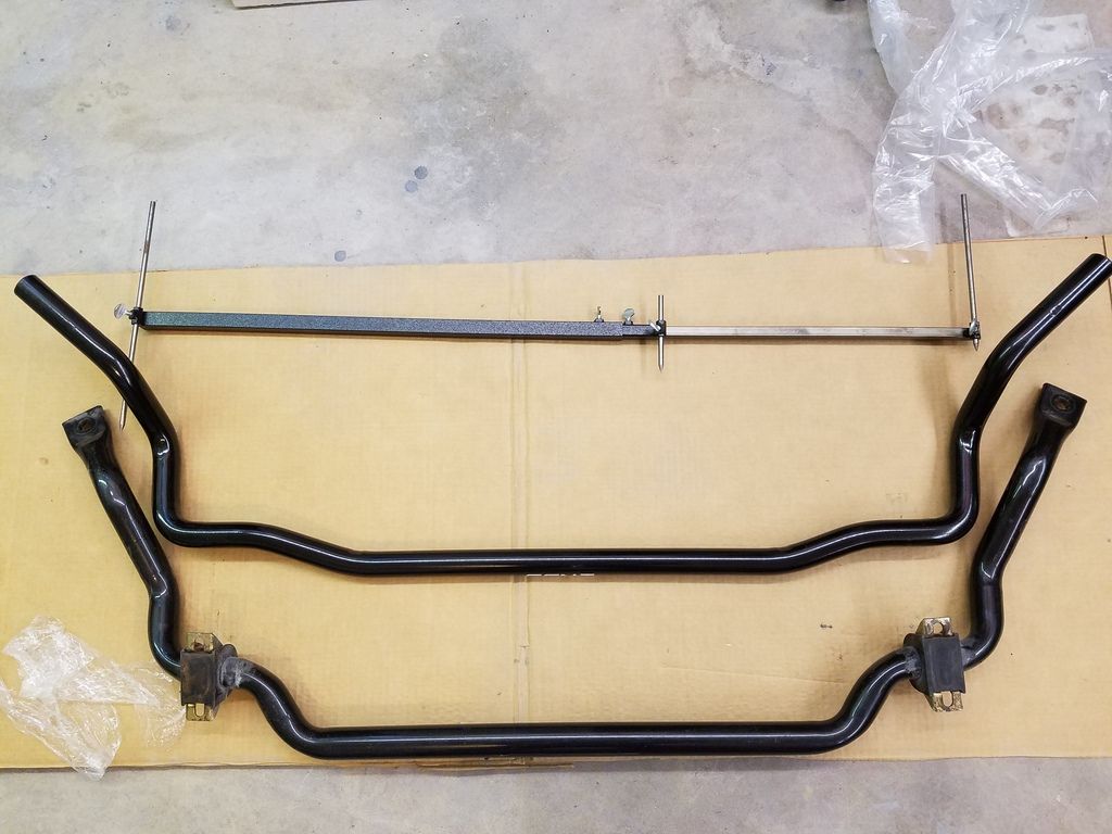

« Reply #9 on: June 04, 2016, 12:55:47 PM »
Here are some more pics from comparing sway bars
This first pic shows a stock 1 .25" bar the end of the bar can swing about 6.5" above the bottom of the frame, this is important if the car is lowered you need to have up swing under bump.
This next pic shows a 1.25 hollow bar (street slip LOL.. ) advertised as being "developed specifically for lowered vehicles" and touted as "greatly enhance cornering performance".....
It has only 350# of resistance as compared to a STOCK 1.250 solid at 380#, it's upward swing is only 3.5 above the bottom of the frame, not good for a lowered car.
Next is the PTFB high clearance bar rates at 460# and swings up 8" above the bottom of the frame.

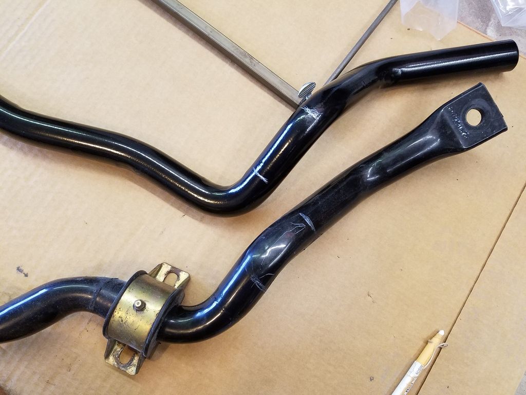

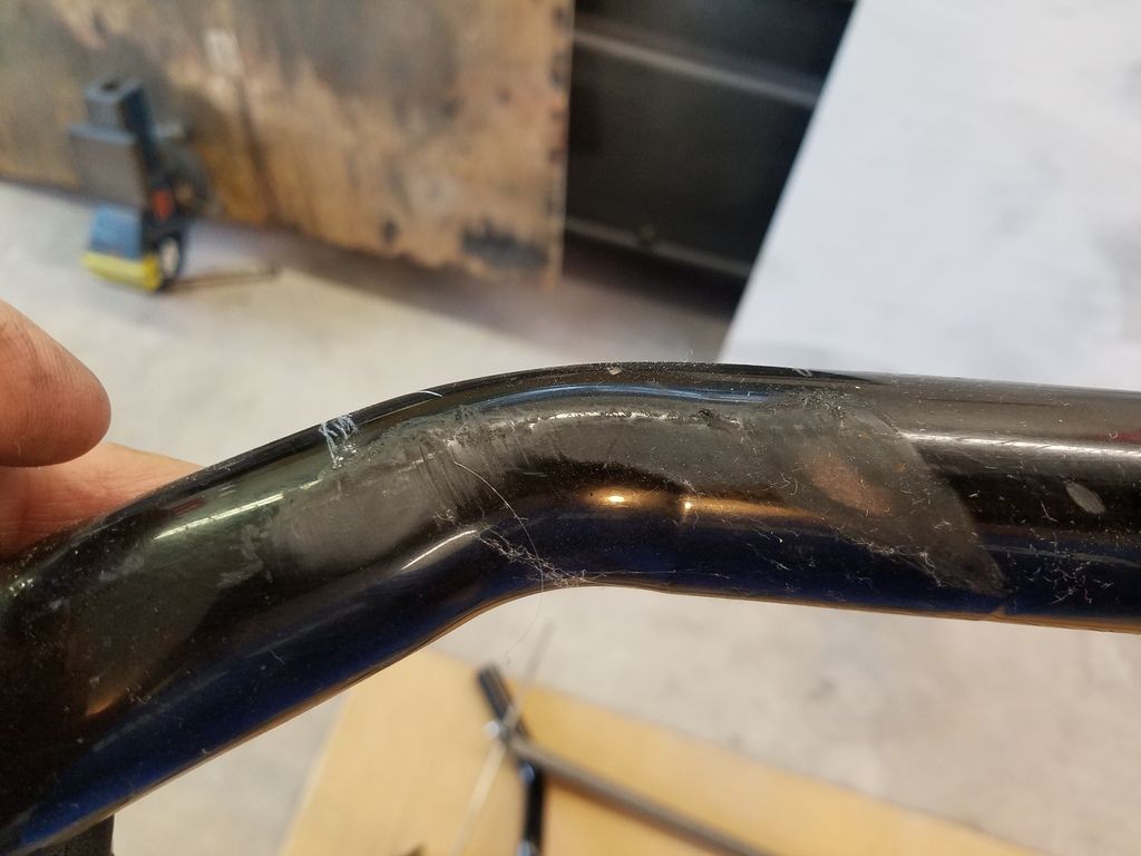

So with that all presented. Here's a look at the problem of trying to stuff the widest tires we can in the front so we can get the most cornering potential. In the pic below you can see where the 275 40 17  tire was hitting my 1 3/8" OD hollow bar over a 10 year time period. It really only occurred in tight parking lots etc. and didn't cause any safety concern to me because it barely touched at full lock. I knew however that moving up to a 285 30 18 on a 10" wheel with 1/2" deeper backspacing tire rub would certainly be an issue so I installed steering limiters which I may or may not still need to use depending how much clearance I gain with the new bar.
Pics below; I marked my old sway bar at the center of the two points on each side where the tire rubbed the most. Then I measured how far rearward the tire contacted the bar from the center line of the frame mounts and transferred marks to the new GEN II bar. Next used my tram gauge to measure the overall width of both bars at the contact points. The GEN II bar is about 1/2" narrower at the forward contact point and about 1" narrower at the rear point. This may not seem like much because it's split between both sides but if I had that extra 1/4" - 1/2" on each side the 275 17's probably wouldn't have rubbed. A small amount of the difference is caused by the difference between the outside diameters with the solid PTFB bar being 1-1/4" and the hollow being 1-3/8". More importantly seems to be that the GEN II bar has a sharper bend just outside of the frame which is almost 90 degrees.

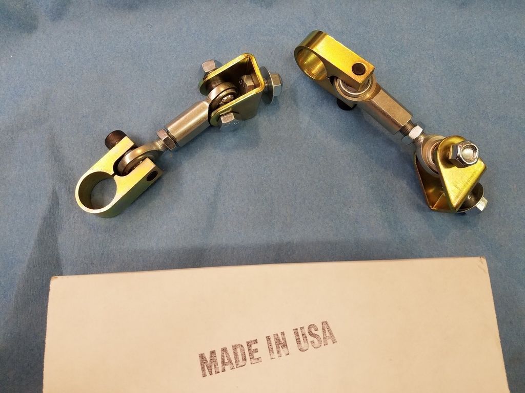

Below is a pic of the adjustable end pieces with the heim joint. At first glance it might appear that the bar clamp and other parts might be anodized aluminum, however they are all very nicely machined steel with 1/2" cross bolts through the heim joint and lower control arm mounting bolt. I don't have a pic of the end links for the standard end link bar, maybe Dave can post one.

Here are some more pictures some might find useful while visiting this thread.  Mine show the same sway bars that NOT A TA compares.  Here you can see how the PTFB high clearance sway bar pitches in to allow more tire clearance by comparison to the big hollow sway bar...
Now here is a picture comparing the PTFB adjustable sway bar end links (bearing joints) to stock style end links (rubber donuts) you get with most other aftermarket sway bars from companies like Hotchkis or Ridetech.  Again, the bearing style end link is what you get with a PTFB adjustable sway bar.  The PTFB 1LE sway bar, however, has ends like you find on a stock style or other aftermarket sway bar.  Notice how the end link on the PTFB adjustable sway bar is able to slide across the sway bar.  This is what allows for sway bar rate adjustments.  The end link is also able to adjust vertically for how high it is spaced away from the lower control arm.

I was able to get this sway  bar installed this week.  While the clearance for the tires seems better, the bar is hitting my frame on bumps making for some nasty noises.  Not sure if others have had this issue?
Is there a way to gain more clearance from the frame by using the end links or do you offer a spacer to assist?
Here’s a pic:

Yeah I’ll give Dave a call Monday.  Here are some pics of the end links and mounting brackets.  I’m currently using the middle hole on the adjustable mount.

Hi Dave - while the tire clearance is better the rubbing noises are still prevalent when going in and out of driveways even at very slow speeds.  Since flipping them over I'm able to get over speed bumps without issues.
Posting some new pics..please let me know if anything looks off still.  Pics of left and right.

Darryl,
Have you tried turning the lower mount for the spherical joint?
Looks like lower will bind up facing the way it is.  I’d try turning it 90 degrees so it’s in line with the upper joint.

Thanks Jon -  no I haven’t tried that.  Just to confirm you’re suggesting me to have the lower bolt pointing to the outside instead of the inside of the car?
Yes, turning the lower joint to work in line with the upper is what I would try.
Also, as I look again, how is the clearance between the lock nut and bar?  I can’t see if there’s intersection there but it looks like you may need to adjust out the upper joint (make it longer) to get the nut away from the bar.
