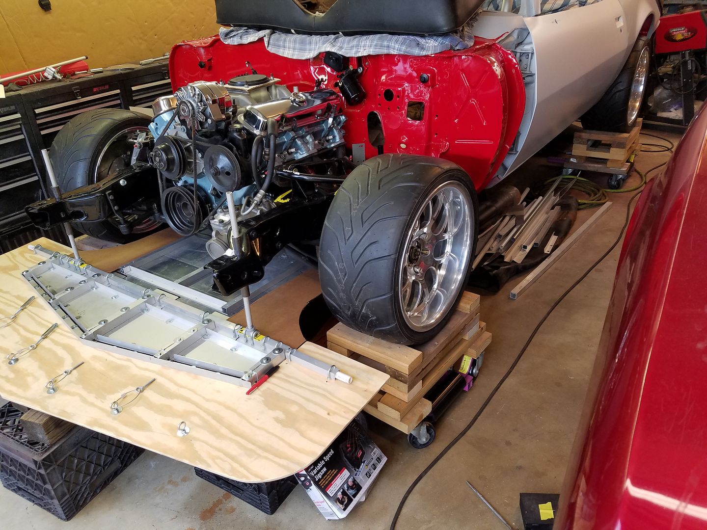

So anyway, I've been working on the under tray for my car recently and figured I'd share a few pics. The car's been completely apart until recently but I've been installing the new PTFB suspension so it's now on wheels with engine/trans installed including the side pipe headers I needed installed to work around for heat extraction. I should be able to fabricate the under tray/rear diffuser sections with the car in it's current state of assembly. Will update my regular project thread on all the cool new suspension and non aero related stuff.
It's been quite a while since I updated so here's a quick review for those who were following along or are just popping into the thread. Keep in mind I don't have any sanctioning body rules and regulations I have to adhere to.
1. Front splitter is 2 piece so I can test different lengths just by making a new (cheap) plywood section. Will be replaced later with nicer lighter permanent one piece unit once testing gets me in the ballpark.
2. Front splitter is hinged at the rear attachment point and suspended by wires in front to the bumper so it can tilt up if I hit corner curbing on road race track. I realize it may "flutter" and require me to make the front supports solid to the bumper, need to test.
3. The entire splitter, under tray, and rear diffuser will be height adjustable and quickly/easily (well fairly)  removable.
4.  There will be five sections to the whole contraption allowing me to change the heights and angles (relative to the ground) of the sections. This will allow me to adjust the entire splitter/tray/diffuser distance from the asphalt independent of the rake of the car itself. This should give me a lot of "tuning" capability. It also allows me to change different sections with different styles and sizes of diffuser tunnels and other features I might want to test.
5. The entire splitter/tray/diffuser assembly will be suspended on poles hanging from the chassis and floor of the car. This is much different than any other set up I've ever seen. Most under tray installations are bolted/screwed directly to the car and mostly sealed pretty well to the bottom of the car. My set up will allow air to freely flow between the floor and the tray from engine compartment to rear and the sides will be open. Hopefully that will allow enough heat dissipation so I don't have to add more coolers for the transmission, rear end etc.  I'm calling it the "Lab-14 Under Tray Design".  If it works well others will copy and if it doesn't work, well, it'll get tossed aside.........
6. With the splitter/tray/diffuser hanging from poles it allows me to have it set as to how far it hangs down but at the same time it can easily be pushed up if it was to hit the ground hopefully reducing the possibility of damage should I have to run over something taller than the ground clearance the tray is set at.
The problem with muscle car era Pro-Touring type cars is that there's a whole bunch of very hot exhaust stuff under the cars. That makes it really difficult to make a smooth floor attached to the body transitioning into a diffuser that actually works to help increase down force (reduce lift). It also makes it difficult to have a dual purpose car used for Auto-X or road course activities without turning the passenger compartment onto an oven if you box in the exhaust between the floor and a proper under tray. The Lab-14 Under Tray Design will allow air to flow around the exhaust removing the heat (while the car is moving) and be completely removable so folks can take it off when they're just using the car on the streets where they'd be sitting in traffic etc.  Now, while the contraption I'm building will be a bespoke combination for my particular car if the concept proves itself to work it could be used on a lot of different types of cars that are used for certain things where there aren't regulations covering what can and can not be done with splitter/under tray/diffuser. Most sanctioning bodies have very specific rules for racing classes that what limit what can be done.
The concept here is that the amount of down force or reduction in lift is determined by the pressure difference between the upper and lower surfaces of the vehicle. The air pressure between the floor and under tray of my design should have a (relatively) similar pressure difference applying up and down so it doesn't change the amount of grip the car has just like having the windows of the car open or closed doesn't really change the amount of grip by any measurable amount. Meanwhile the very high speed air under the tray will have less air pressure pushing up on the tray (Think of it as a slight suction increasing the weight each tire receives).  The combined area of the splitter/tray diffuser I'm making is roughly 11,000 Sq. In. so a change in air pressure of .1 lb (sea level is about 14.7 Lb) would result in an increase in down force (reduction in lift) of over 1000 lbs.  That would result in a tremendous difference in cornering capability so even if I don't get anywhere near that the whole project might be worthwhile. If nothing else I'll learn something even if it's that my idea doesn't work.

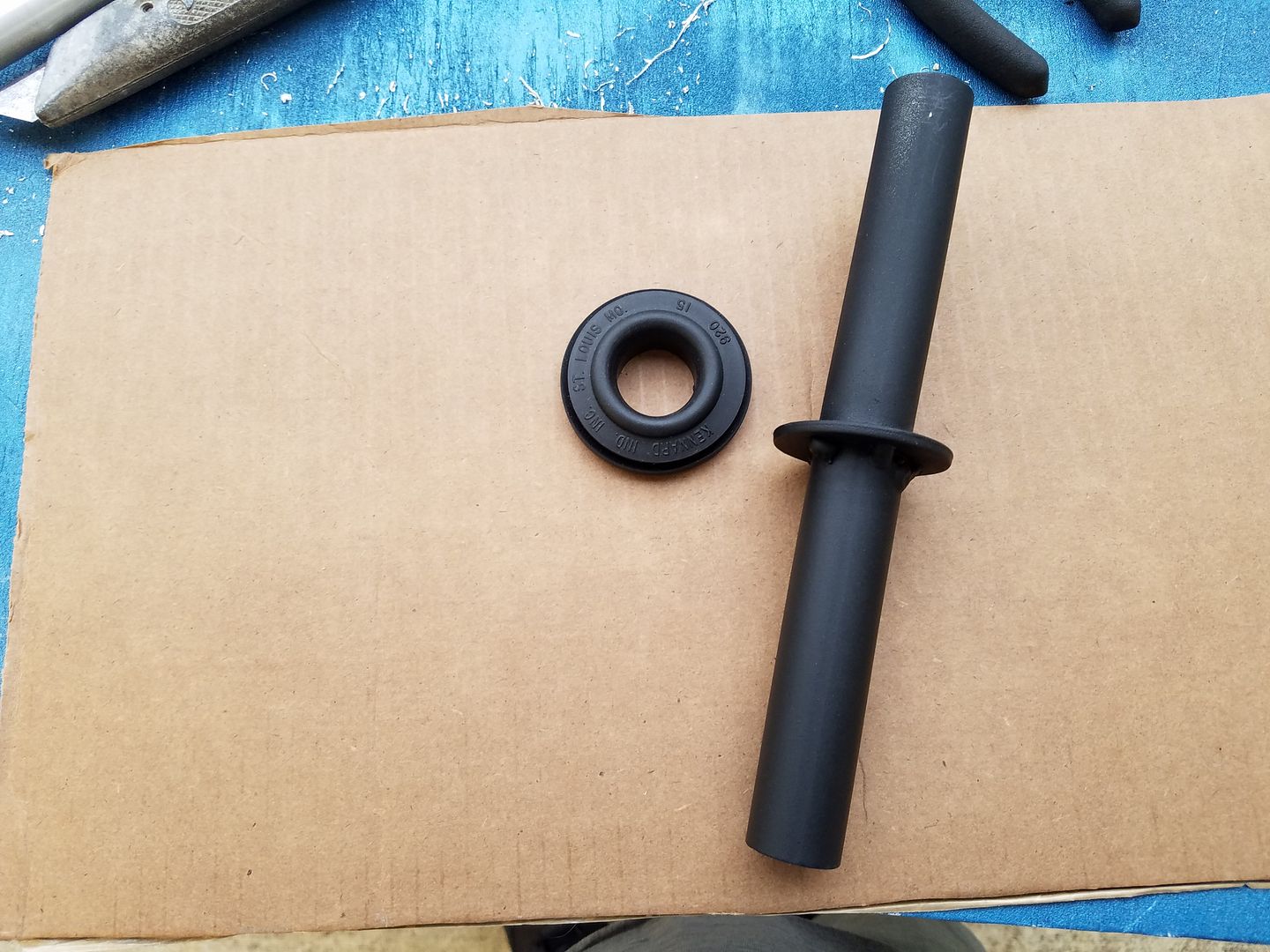

On to some pics! This one shows the splitter and how it hinges on the tubing inside of the box tubing as well as the tubes inserted in the sub frame. The vertical  aluminum tubing will have holes drilled through it that a spring clip gets inserted through so I can set the splitter at different heights. I was trying to use up old scraps of stuff to make my test pieces so thats why there's panel sections in the tray part under the engine. If everything works I'll make nicer lighter pieces later on after testing.
Toward the rear of the engine compartment there is another set of vertical tubes welded to the sub frame for aluminum height tubes to slide into like the ones at the splitter along with another hinge set up where the panels join. This separates the engine section from the section under the cowl area.
There will be a set of height tubes in the cabin by the base of the A pillar and another set in the rear seat footwell. They will function similarly to the ones in the engine compartment except that instead of being welded in place they will be inserted through the floor of the car through a rubber grommet. The steel tubes have a washer welded to them preventing them from sliding down. I will make some caps that insert into the grommets for when I don't have the under tray installed. The aluminum tubes will function the same with a spring clip holding them up and still allow the tray to rise if necessary. I made a set for the rear supports in the trunk also.  These will allow quick changes to the height and pitch of the under tray from splitter to diffuser without having to go under the car.

Here's a couple more pics of my contraption laid out in the driveway so you can get a better idea of what I'm doing. Still need 4 more support rods and a couple sticks of box tubing as well as some aluminum sheet, but it's coming along! The big white sheets are a couple different thicknesses of corrugated plastic. With side pipes I don't have heat/melting issues from about the front seats back in the middle of the car. The curved up section at the rear is measured to be pretty close to what the actual diffuser will be when finished.

What is that surf board going to weigh? It's neat all of this aerodynamic testing. Some major forward thinking. Just curious as to the weight addition. To me blocking off the sail that is the under car should prove beneficial.
Sorry I missed this question back in Sept.  The whole contraption that will be used for testing is just over 100 lbs. If it works well I'll make a lighter version and think I could get down to 50-60 lbs without using carbon fiber. If my disposable income level rises and I could go with some carbon sheets etc. I think I could get down under 50 lbs. Most higher end race cars now have one big flat carbon fiber sheet now. You can see it in these pics of a Mercedes AMG World Challenge car I got to poke around.
Sticking out the sides below door in pic below to reduce air getting under the car and perhaps also create a virtual seal with a vortice. The aerodynamicists that worked on it would know.
You can see the flat carbon fiber sheet in pic below under the air jack.
