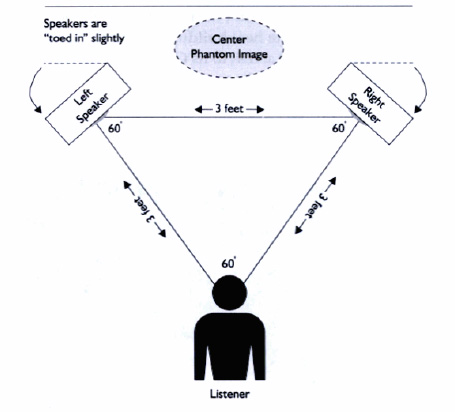

It's EXTREMELY important.  Stereos...stereo vs. mono.  Stereo = a left and a right.   Where are there 4" speaker you want going to go?  One on the left of you and one on the right?  So is it stereo now?  See where I am getting at?  I cringe even more when I see people cut up their beautiful center console because all the do then is make a mono/center channel speaker there.  At least the center dash is the factory location.
If the center dash is the only place you will have speakers up front, I'd go for a single 5 1/4" good speaker.  Unfortunately they are usually only sold in pairs.  Next option is put a set of 4" in there.

See below?  You want speakers to be further apart to the left and right of you in order to get that sweet spot where it sounds like there is a left and right speaker and that center filled with sound too.  The further away in front or behind you the speaker are, the smaller that angle at the listeners head becomes, and that then makes the speaker sound like 1 mono speaker - that's what speakers in the back of our firebirds sound like, a single speaker at the end of a tunnel...
You can have a single set of $300 speakers in the rear or a single set of speakers (or just 1 speaker) in the center dash costing $100, the cheaper speakers will sound better- it's all about speaker placement.   So if I were you, I would take that $300 and spend about $200 up front on a set of 4", and in the rear get a set of 2 way $100 6X9s.   You'll be getting some decent bass from the 6X9s as well as a little bit of that stereo separation (that you will not have AT ALL up front using the stock locations), but from the front you'll be getting EXCELLENT sound quality and crisp highs!  ALWAYS spend the most for up front speakers.
