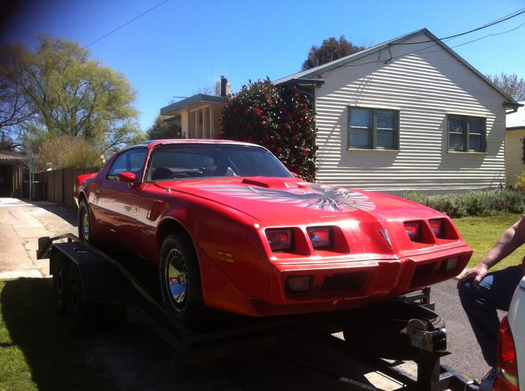

So it all began by traveling out the Orange NSW 3 months ago (Sep 2014) to collect the car, which is about 5hrs from where I live. The car started but was only running on 5 - 6 cylinders and sounded all round pretty ordinary. Interior was shot, floor pan had rust. It was in need for a complete restoration.
I did pay probably a bit more that what the market value was, but at the time I didn't realise the extent of the rust and repairs. It appears that the previous owner must have bought it also for a restoration and then freaked out when he saw all the work involved.
I am late to start this restoration journal as I was struggling to find a forum or group to join up with, however I found myself on here quite regularly due to the good information, constantly people being on here and also being a link back to Australia on here. So here I am.
A few of these pics are already floating around on the site as I have had a few discussions already about a few things on the car... My goal is to have the car running in 12 months preferably but definitely with in 2 years ( that's plan anyway )
Loading up to bring it home...

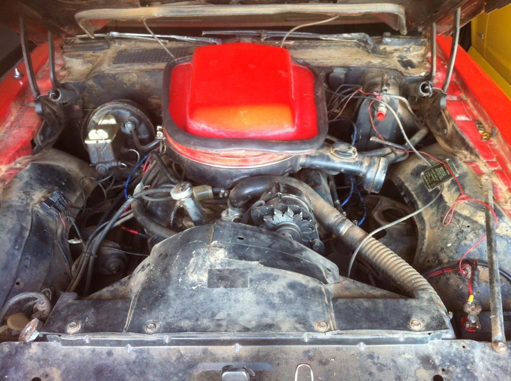

First thing I did for the fun of it was to see why it wouldn't run, I found 2 x spark plug leads in the wrong locations and also a dud spark plug. I replaced them and it started and ran better but would not idle still. I found that there were vacuum lines that were not on... I had my dad helping me the whole way through as he's retired and itching to do something, why not build my car...
  <------- Engine running video, sounds pretty awesome, apparently the previous owner couldn't get it to run... Hasn't run in years... Bringing it back to life, something still wasn't right though...

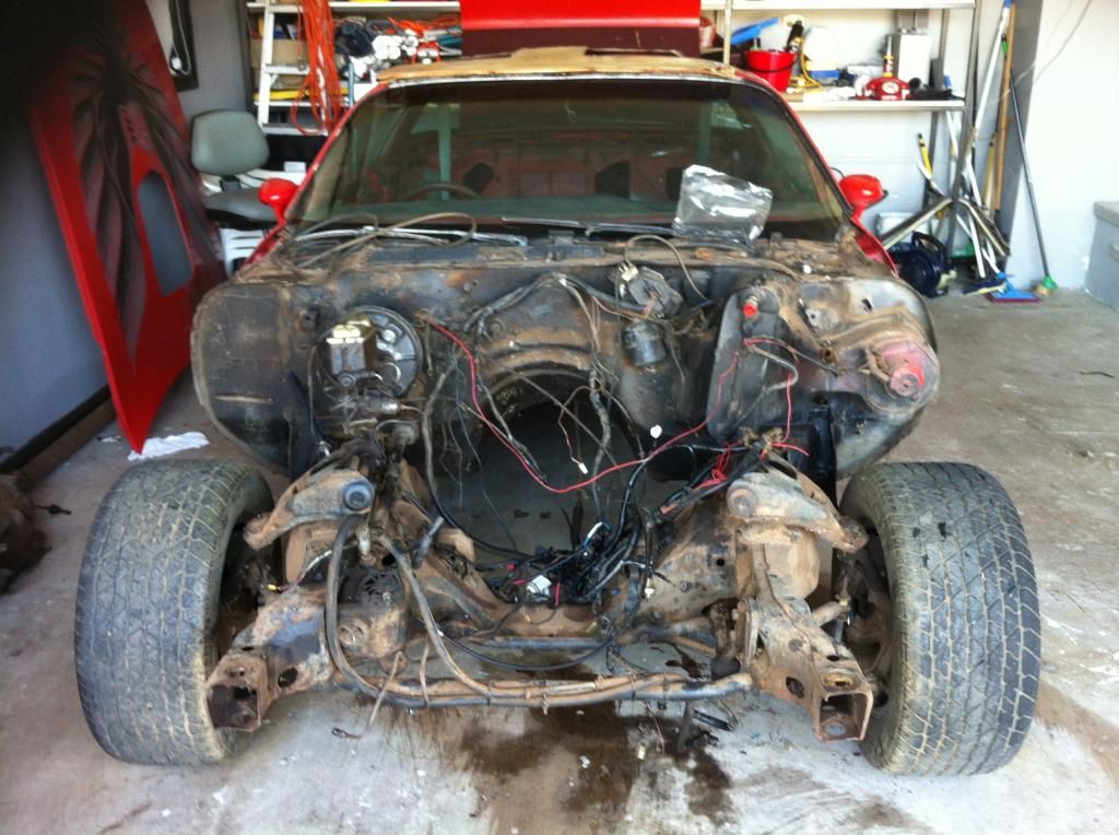

From there I checked to see what worked and didn't work, most things didn't. I checked the lights on the car and it nearly set the car on fire. There was a short in the wiring at the head lights and the whole harness started smoking, it was a complete mess, no solder on the repairs just twisted wire, scared me from what else is like that. No idea why it didn't blow a fuse. So I repaired the wiring in the head light harness and it worked perfect after that.

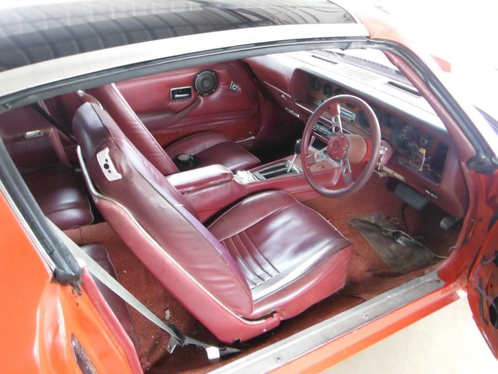

Time to remove the interior and find rust and lots of it... Both front foot wells and toe boards and also under the front seats, plus a bit under the back seat
Engine time now...

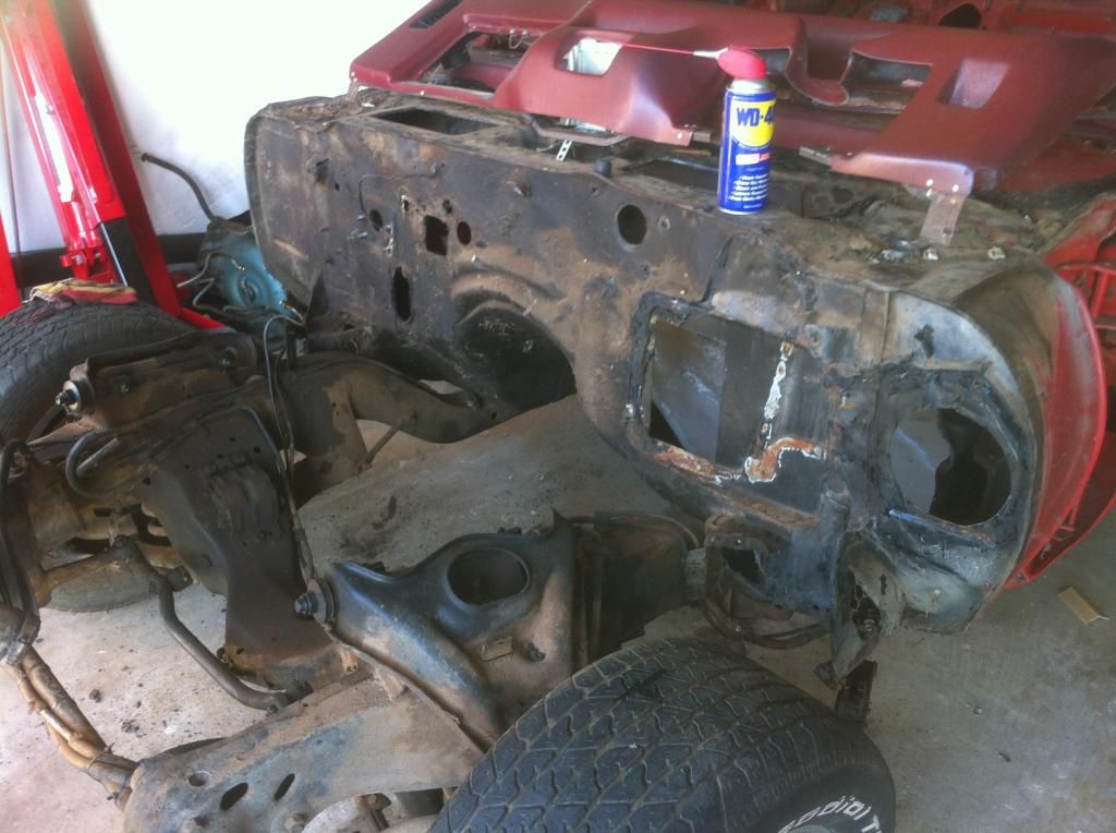

Then guards
The rest of the stuff on the fire wall
And this is what I'm up to currently as of today.
My next step is to loosen off then re-tighen the front subframe and also the rear suspension so that when it goes to the sand blasters in a few weeks time it can be easily lifted off onto a rotisserie.

Started pulling down the engine this afternoon, first I broke a bolt in the inlet manifold where the EGR actuator sits, then broke an exhaust manifold bolt... Spewing, I'm not the best at removing broken bolts...
Any way, inlet manifold came off and I noticed something...
One is not like the others...
I continued the dis-assembly and found that the engine dropped an exhaust valve which then let the push rod fall out and bend... Nothing worse then a bend in your pushrod...
 - The camshaft was overall in bad shaped, on the lobe where the dropped valve was it was ground flat.
 - The oil condition was really really bad and sludgy, water has been through it at some stage.
 - The oil pick up appears to be way too high, I noticed that someone has written on the crank with white pen marker, 0.010" Mains and bigends, So I'm assuming when this happened they pushed the oil pick up by accident when refitting the sump, very lucky the engine did not starve for oil.
One thing I learned is the way the oil pump works in the engine, pretty funny way making it work, is this standard on these V8's? Is this normal for the old V8's?
I did not remove the pistons and crank as this is the only think left because I'm running out of real-estate in the garage... I did noticed a bit of a lip on the cylinder bores which i'm not very comfortable with so I would say more than likely I will get it bored out so might as well go 0.030".
I noticed that the camshaft was able to float back and forth and nothing was actually holding it in place? Is this correct? Shouldn't there be a retained to hold it in place?
Cheers
Bill

« Reply #37 on: April 14, 2015, 03:02:46 AM »
Sorry guys, sort of forgot to keep the updates on mine coming through....
Left for the panel shop mid march
Below is the mock up with its new bonnet and nose cone...
The new body mount rubbers are in for the gap measuring and front end all aligned.
I tell ya, it looks good with no springs in the front end...
Well things are rolling along nicely, car has had some of the small spot holes welded up and the R/R lower quarter panel replaced. A bit of shaving and building up of steel to make the gaps to what they should be.
Below are a few pics
First Pics, the panel guys told me that in the old days the used to use lead to make the joins of the panel on the roof. They have told me that they are going to remove this lead, I think it had something to do with the final colour finish and how different surfaces give a different colour even if its the same paint.
Lower R/R quarter panel patch.
Deleting the side moulds
Door gaps - Building up the steel on the door fill in a gap
Boot lid and spring cover gaps
I'll keep you guys posted...
