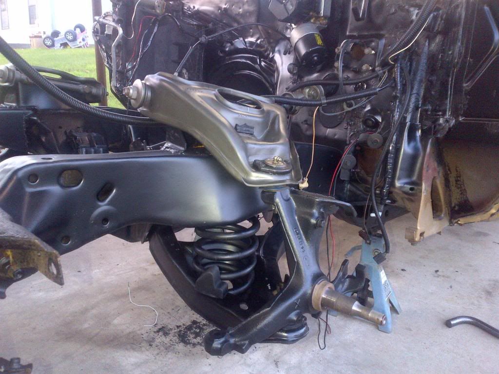

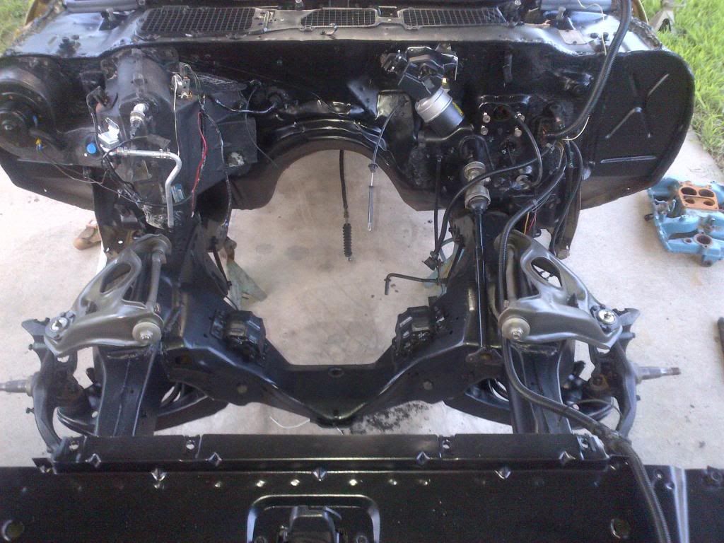

Well I hadn't posted progress lately but I have been making progress its a far cry from what it did look like and started the reassembly process. Some of may not be exactly a factory appearance but I think it looks awesome and so does my wife and that's saying a lot as she hates the TA for some reason??
I went back with the same springs I was going to lower it a little but decided against it but it is now sporting all new bushings, bump stops and looking nice and fresh.
I did get the heater core changed out and while I was in there I removed all the air ducts washed them as they where nasty and put it all back together. The condenser housing had a hole and a crack in it from the previous owners handy work so you can see in the pics were I did a fiber glass patch and resealed the entire box good as new. I replaced the wiper motor, plastic cowl vent, new soft seal, and repainted the wiper mechanics turned out nice.

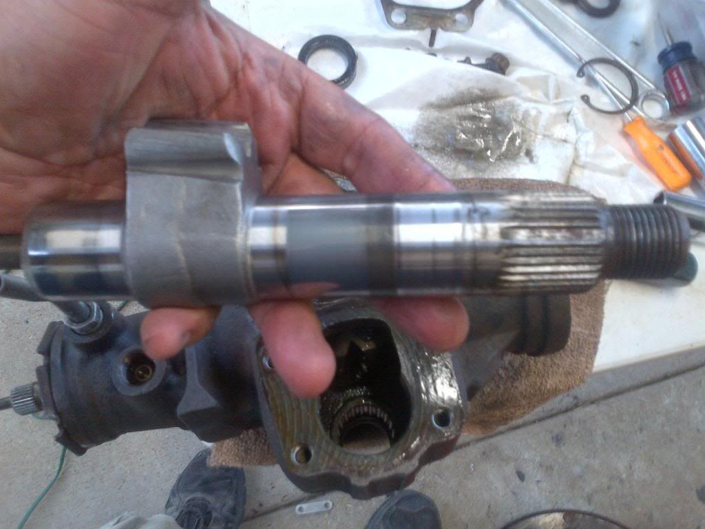

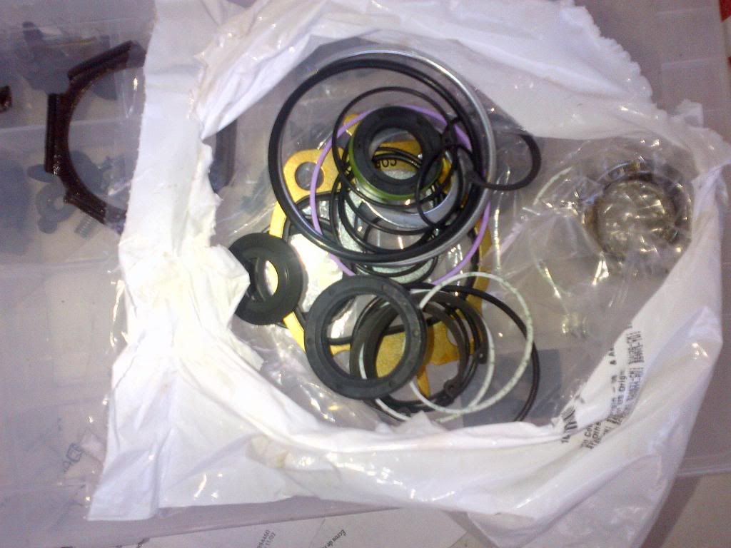

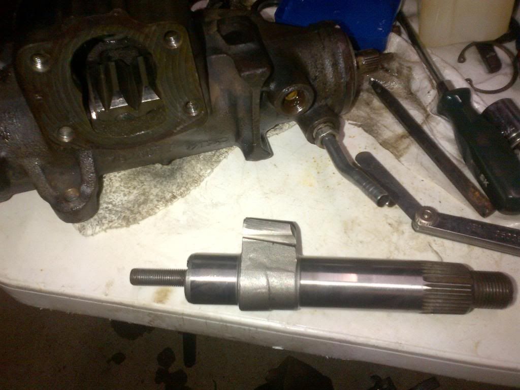

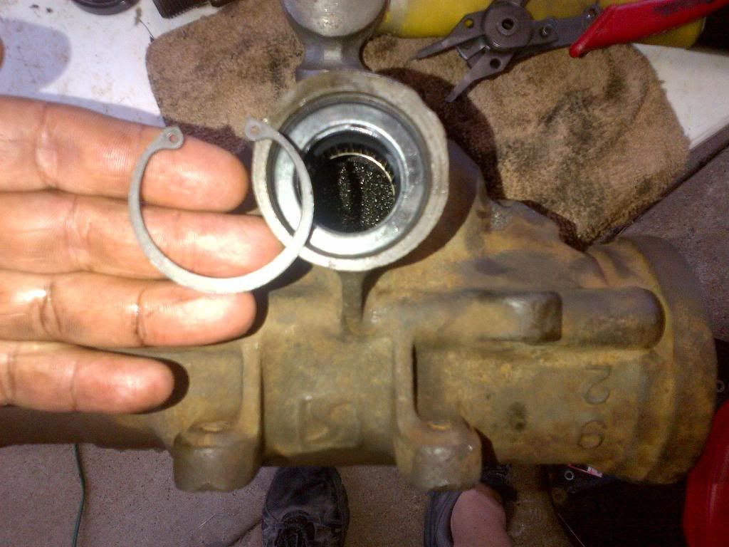

Next I ordered a rebuild kit for my steering gear box the input shaft seal was leaking. Once I got the rebuild kit and opened it I almost decided to just change the seal that was leaking as the repair kit is a little intimidating! But I figured what the hell its do or die so I jumped right into it.
This is the out put shaft I didn't get any pics of the input shaft seal but they looked just about the same. This was very time consuming (took 4.5hrs) and tedious for me anyway so I didn't get a lot of pics.

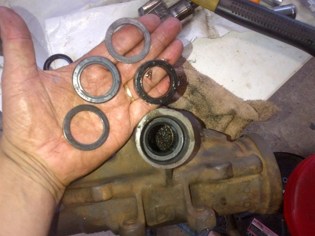

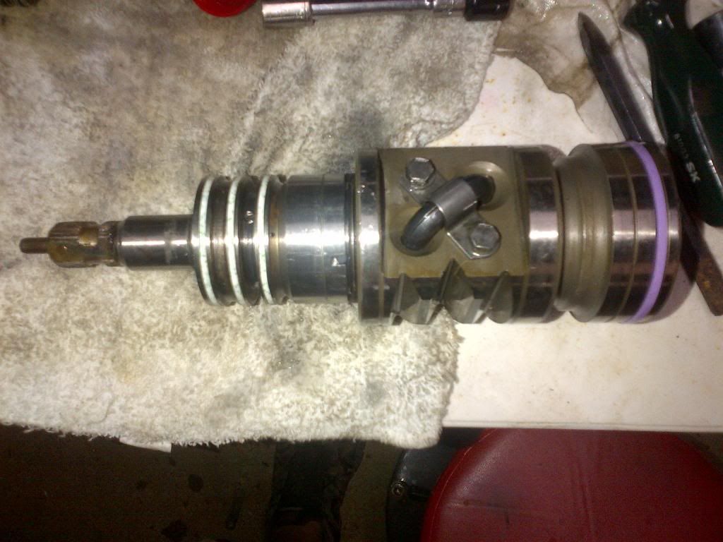

These are the shaft seals and washers they just stack one on top the other and held in with a simple C-clip

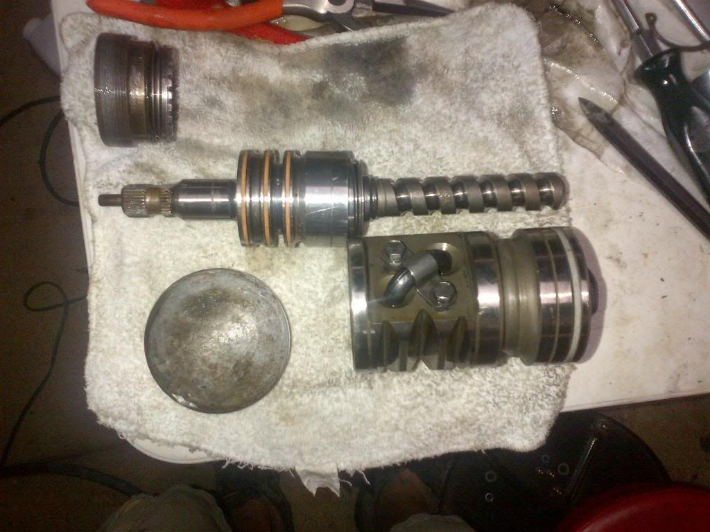

This is the internals of the worm gear and out put shaft seal I did get a pic of it note the orange and white colored seals
There are 3 seals followed by 3 O-rings that make up the out put seals to the worm gear and the purple seal is on the piston it is now ready to go back together. The piston and worm gear housing went in from the back while the worm gear went in from the front I'm sure I did this wrong from what an experienced rebuilder would had done it but this way worked for me.
I polished up the out put shaft before reassembling it

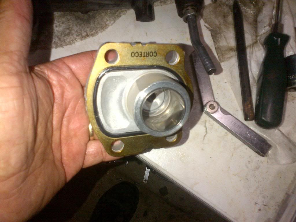

This is the top plate it has a metal backing gasket that you replace.
The finished product I did bead blast both aluminum housings and today after work I will strip the gear box and repaint it cast iron gray it was to late last night to get it all done I started this at 6pm and finished at 10:30 last night. Like any thing else its a learning process I think I could do it again in half the time but I hope that isn't going to happen as I did not like doing this!
