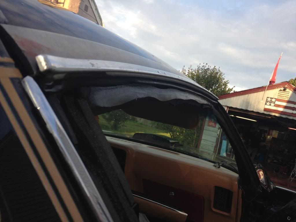

well i have been talking about it for months but im finally back with my baby. to start things off here is some pictures of around the car and inside it. its messy i know, i was working on the brake caliper and putting in a new door handle at the time but okay lets get started.
this is a shot from the passenger side, the dash is a bit torn apart because im working on the gauges and putting in that stupid printed circuit. replacing bulbs..etc.

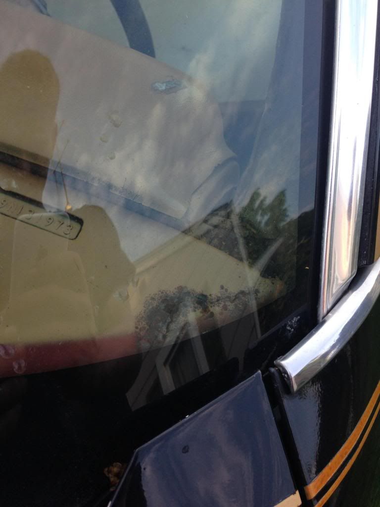

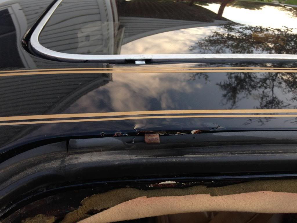

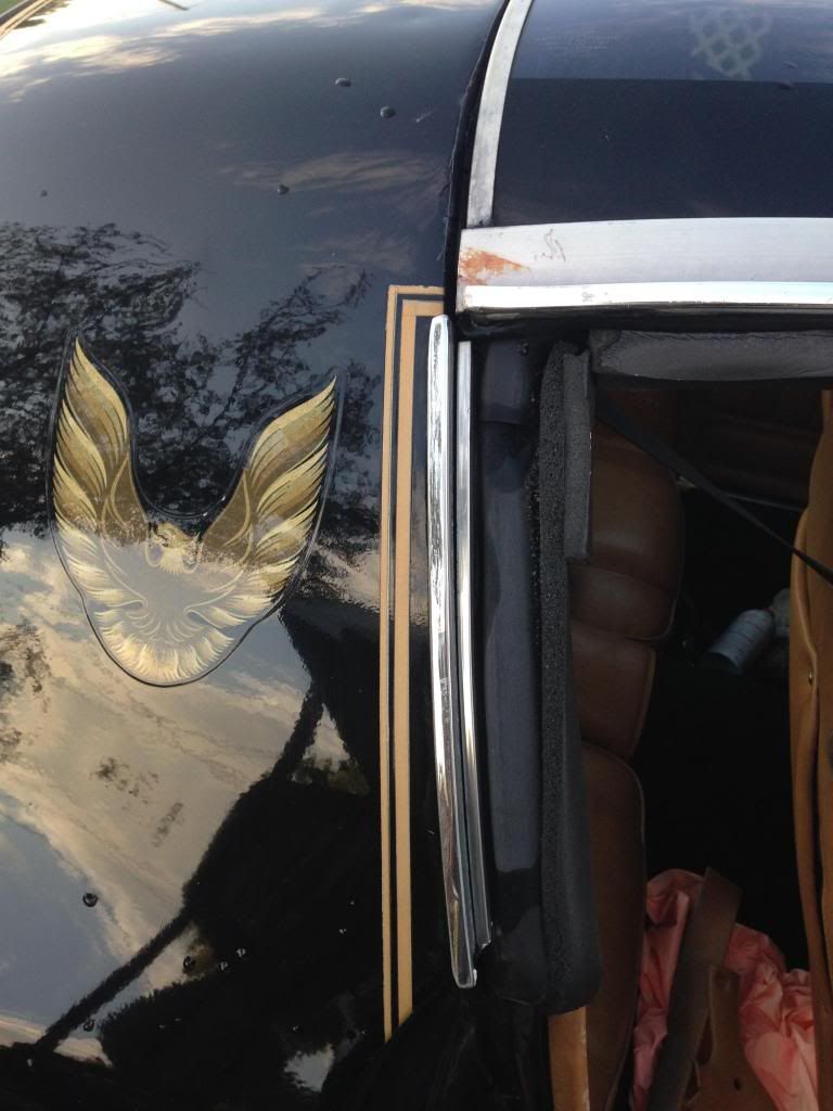

this is the rust at the pillar and its getting worse, when i get it painted and pull the windshield i plan on getting the replacement part and welding it in (hopefully)

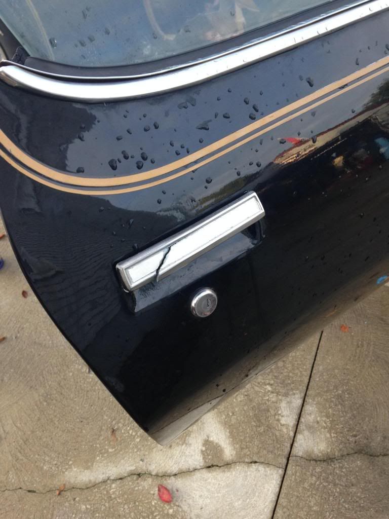

just replaced this today, anyone who didnt know how to open my door just made the crack bigger, so i got a replacement from ames. its a little too long but it was the 15 dollar one.
now what can i do about this? any ideas? the body filler someone used is cracking out and these are loose and the rattle

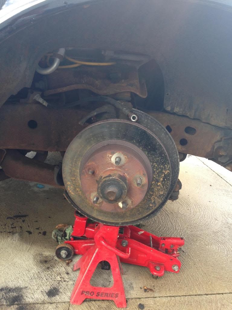

and lastly i was working on the caliper because it was so rusted and the pins were seized up brake line busted. but its going well, i need all new suspension parts, sway bar links, tie rod ends, ball joints, stuff like that, they are all starting to dry rot

If the car is outside, fixing the roof centre would be my first job....you'll need to pull the headliner and seal, cut that rust out and plate in some steel. Luckily, if you're paying someone, thats not a complex panel / section to repair.

My driver door handle had an identical look to yours before I replaced it.  My t-top also has a similar area.

If you repair that roof section, clean it down to bare metal, deoxidize it, then prime properly....use a spray auto paint can top coat to seal it, don't leave primer open to the air. That'll hold you till the car's painted.
