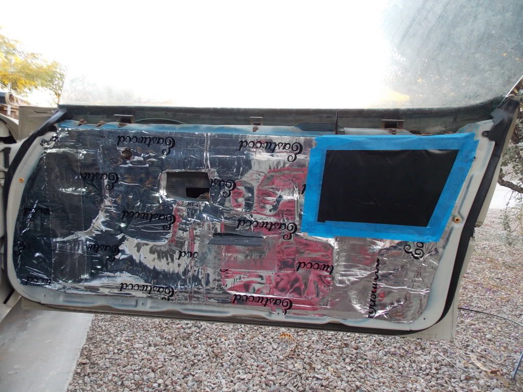

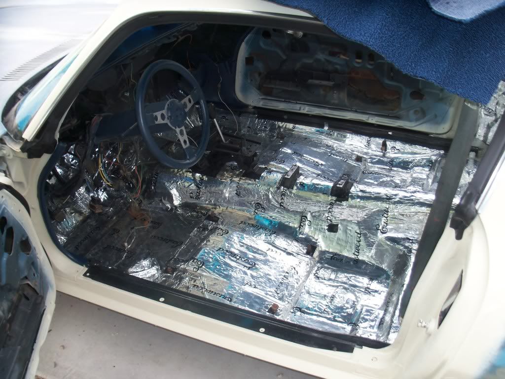

* At this point in the build  I needed to make some decisions- I know it seems like a weird time, but thats how it came down.  What is my plan with this car?. ..   I decided to keep the dark blue interior as I am tired of doing black.  I dont like the blue on blue- so the 'lucy' goes.  I figure i will go white -possibly with a blue stripe to tie it together.  I want to keep the formula hood but add a spoiler to the rear.  My children insisted on me leaving the wheel spoilers off, as they feel some kind of ownership here.  :lol: I like TA fenders and i have no loyalty to the 1 yr only 71 fenders- so, that goes on the list.  I hate vinyl tops- so that is going.  I will clean it up- but not go 'frame off'.  I dont plan on rebuilding the engine until it needs it.  So- thats the plan-  i want a perfect body, like new interior, solid drivetrain- and when the need arises i will restore that.   Now for a shopping list.  I found a guy locally who sold me 2 PERFECT trans am fenders for $100 each and threw a spoiler in for another $50.  The front bumper is pretty bad- after researching all about the endura i decided to go fiberglass.  I figure it will clean up and paint more reliably.  Found a nice one for about $125.   Pretty much ALL of the enterior needs replaced- so an order goes off to Year One.  Found a BEAUTIFUL Camaro console for about $60 (i'll make it work!).  The dash was REAL bad- I decided to go with a dash 'cap'.  Mine was SO bad that i had to get a donor just for the cap!  that ran about $40.
wearing 1 new  fender-
Since I'm going to be doing everything at the same time, with no garage, i also need  a plan of how to progress- this is where it got REALLY hard!  I needed to clean out the interior and start restoring it, while finishing rust repair, hanging body panels and getting the car driveable all at the same time.  I know the best way is to finish all of the mechanical- then body and paint- and finally interior.  Again- with no garage that is tough.  I figure i will get the car into nice interior first- and then i can work on the body while im using it for a 'sometimes driver'.
I wanted to get the car back to my house to do the bulk of the interior- so this is where the order gets tough.  I need front and back windshields to drive it home- but,  I want to get a headliner in it while the windshields are out.  The plan becomes: Gut the interior- fix any rust- coat the whole thing with POR15, clean the inside roof, install sound deadening in it- install the headliner, paint the dash, get windows in it, get some wheels, then throw a bucket back in and drive it home.
Gutted interior- and a new steering wheel! :)
New headliner and windshield-
My first headliner and it came out great!  My one big regret is that i didnt 'foil tape seal' between the patches of sound deadener under the headliner.  This may come back to bite me in the booty...  there is already one little spot where the black rubber has dripped down onto the headliner and is showing through the little holes...
skipping ahead a little in this pic- but:  the car with new wheels now at home and ready for some work!

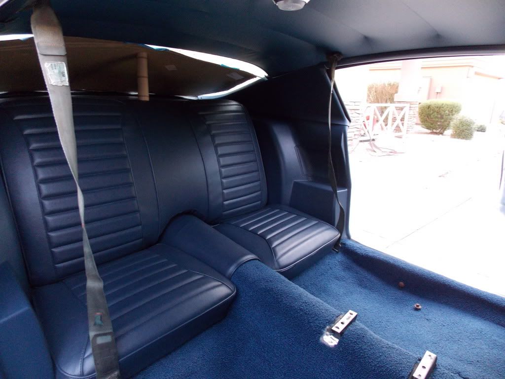

* Sorry if this thread is running by quickly.  It's a little tough recounting this in hindsight- soon, I will be caught up to real time.  I'm happy to answer any questions along the way.
So, now I find myself in an odd spot.  I have the car at home with new windshields and a new headliner, but otherwise gutted.  I spent ALOT of time walking around the car, looking... thinking.... trying to find a path for action (thanks alot OCD!).    The path I decided on is very unorthodox.  I wanted to work on the interior AND strip the body down at the same time.  If I was going to put all of these new interior components in, I wanted to be sure it would be safe from the elements.  That means weatherstripping- a touch usually saved for last.  But if I was going to put in weatherstrip I would need to remove the drip rails and trim, clean the old stripping out, prep the jams and edges and primer.  That is where I started.  Pulling all the trim and stripping and cleaning.  Then, epoxy primer on all edges, replaced all trim and install new weatherstrip.  I then finished cleaning the floors and coated them with POR15.  I picked up some "Thermocoustic" sheets from Eastwood for sound and heat.  Some people prefer to use smaller pads of the sound deadening in strategic places- that is fine, but I decided to go overboard since I live in the desert and needed extrem heat protection as well.  I completely covered the floor and up the firewall, the trunk divider and package tray, and went extra heavy on the wheel wells.  Then installed new carpet.  I also put some thermocoustic pads inside the door shells (against the in side of the outer skin) as well as covering the inner door behind the door panels.  I used about 3 boxes and they constantly have sales on it- sometimes with free shipping.
I then went ahead and turned my attention to an item that had been troubling me- the roof.  It had some problems from it's former life as a vinyl top and was showing surface rust among the leftover adhesive.  WOW!   what a chore cleaning that all up!  I also began stripping down the entire body to bare metal.  I know I probably should have considered blasting, but I sorta like doing it by hand- watching the layers go away, telling you the story of EVERYTHING that has happened to it.  Each section was put in epoxy as it was stripped.
Simultaneously to the body stripping, I began work on some of the interior sub-assemblies.  Starting with the bucket seats.  They were pretty rough and had been covered with some cheezy replacement interior- meaning TWICE the hog rings to cut.  I got them completely tore down and then spent some time cleaning and repainting the seat frames.  I picked up some "zig-zag wire" to replace some broken springs.  I then replaced the foam (with interior springs) and installed new seat covers.  Thanks to PUI's online video tutorials, these came out fantastic!  The last few wrinkles will dissappear once the car has sat in the hot sun for a while.  I also cleaned up the seat tracks and got them moving again, then repainted them and greased the bearings.  Installed new plastic backs and hardware.

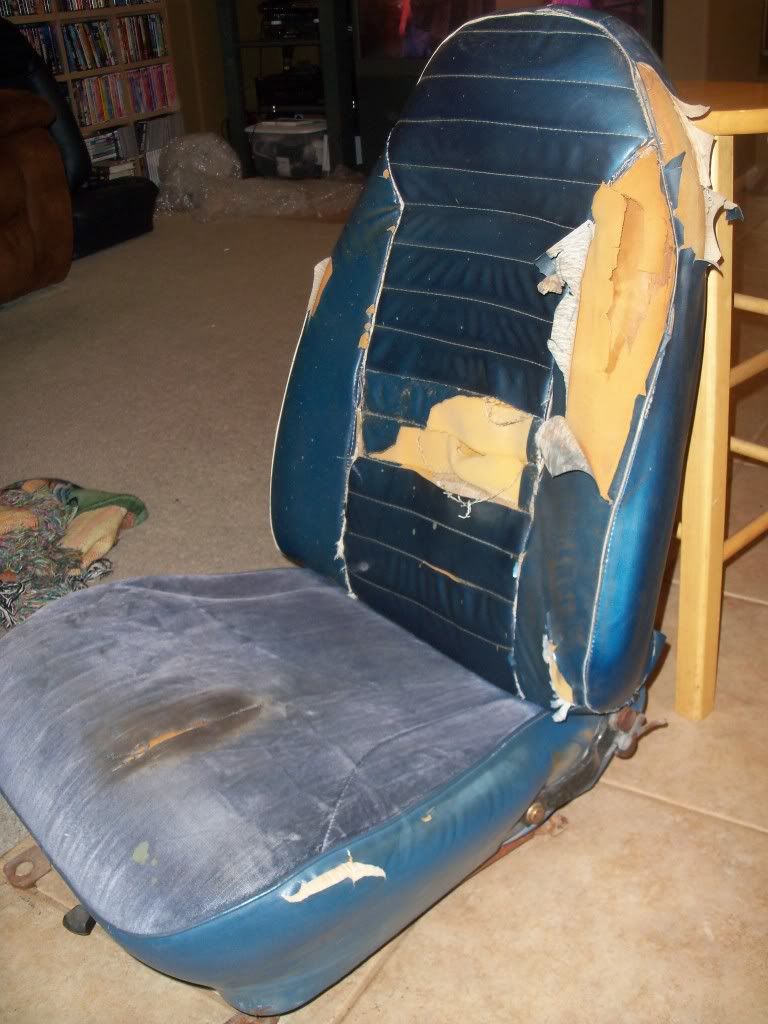

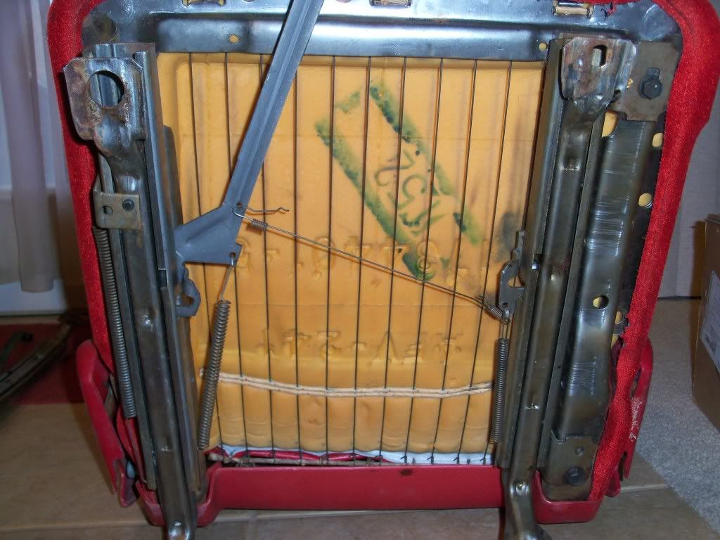

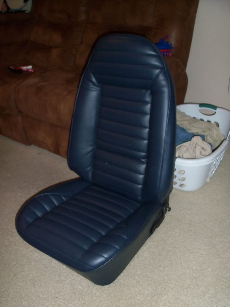

I only wish the rear seats had gone so smoothly!  As I tore down the rear seatback, I could see where the leaking back window created some rust issues with the seat frame.  I cleaned it up and treated the rust.  I ran to the store to pick up some new foam (expensive!) and some round stock to weld in to the really bad spots.  As I was getting ready to start welding, I realized I should tear down the seat bottoms also, to make sure they didn't need welding also.  Good thing I did!  The seat bottoms were trashed under the covers.  I realized I needed to find a replacement rear seat.  Most online sales had super high shipping because of the size, so I checked out my old nemesis: craigslist.  I found a guy selling a full set of seats so I ran to check them out.  He had a BEAUTIFUL set of 1981 red Pimilco seats, front and rear.  He wanted $100- DONE DEAL!!  I was thrilled!  I got home and pulled the nearly perfect seat tracks off and sold them on ebay for about $200.  I then gave the buckets to a buddy to use on his project.  It seemed like a shame to tear these covers off of the rears- but it was neccessary.  They looked like they had never been sat on!   I pulled the covers off and checked out the frame- WOW! perfect shiny metal!  A quick spray of paint and they were ready.  I wouldn't even need the seat foam I bought because these molded foam pads were so nice.  So after a short sidetrack due to a rattlesnake hiding under one of the discarded seat covers (  :shock: )  I began the chore of installing new covers- what a chore!  They kinda were fitting goofy, leading me to question- are these rear seats really the same?  Are they interchangeable?   I got the covers to fit in a way that i don't think will show hogrings- but they definitely seem different.  I then installed some newly painted interior trim including rear armrests and sail panels.  Time to fit the rear seats- and...  they ARE different!   The '81 seat is a bit more narrow and allowed the shiny foil of the thermocoustic to show from the sides.  It isnt TOO bad so I used some 3M spray adhisive and layed some trimmed carpet strips behind the seat.  The seat bottoms also fit a little weird- they were super loosey goosey, so i wrapped the bar that latches into the floor with carpet pieces to help it tighten up.  It should be okay as I don't expect to use the rear seat much anyhow.
Here is a shot of one of my donor seats- I just want to point out that there ARE great deals out there if you are patient and willing to JUMP on them when you find them.

*  Next up:  door panels.  Again, an example of my gen 2 ignorance.  Pieces I don't recognize and prices I dont understand  :lol: .    Started by tearing down the door and cleaning inside and out, then cleaning any rust and painting the inner shell.  I had to repair the bottom door stop and replace the felt window guides.  I bought the little adhesive felt replacement pads- but I'm not thrilled with them.  I don't think they'll last.  I got all new door components from yearone.  Fbodywarehouse videos were very helpful with the install process and I picked up some hardware from them.  I decided instead of a water shield behind the panel, I would just completely cover the door with sound deadener sheets.   When my parts arrived, I made a quick discovery that the bottom door armrest panel did NOT match my original.  Nice that the parts catalogs list this as a 70 - 71 lower door panel when it is apparently a Camaro only part!  I decided to use it anyhow and painted it to match my interior.  I didn't have the hardware to connect the lower panel so I just lined them up, made holes with a pick and ran screws and washers from the backside.  I also found that the brackets on the door shell were all wrong for this lower panel.  I eliminated one of the brackets, and moved the other so it would line up with the screws through the armrest area.  The bracket also neened the screw holes elongated to match up.  When mounting the panel I found that it is quite a bit different from other gen 2s and there wasn't alot of info around.  Basically, each door gets 4 of the nylon plugs with metal clips along the top and then screws around the rest of the door.
...the armrest pad is just sitting on the panel in the pic, the color is a little off- i may also try some trimming to be sure it fits tight.

Roof looks fantastic for a vinyl top! Looking good!

very impressive work, I like it.   Interior is looking fantastic.    I would have expected a lot of rust under the vinyl top.  keep up the good work.

Looking very nice, I really like the dark blue seats and door panel. I would not worry about the extra screws, I did the same thing but since my interior is black I was able to paint the screws before installing (they blend in very nicely).

No one repro's the correct lower door panel for our cars....its a pity. Camaro one looks good, though.
Maybe switch over to black phosphate screws so they don't stick out so much!
I dont mind the scews showing- i kinda like it.  although black would look nice.  they are the proper screws with the little trim rings on them.  My original problem with them was just determining how to hang the panel on the door because most tutorials go over later doors that use the plastic clips.

I'm really liking the dark and lighter blue contrast also you were lucky enough to find a one year only console with seat belt holder/rest bracket. Looking really nice.
