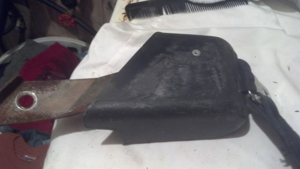

I have read some posts where people have tried to remove seatbelt bolts with mixed results (stripped threads and a truck load of trouble)
I am going to paint the lower plastic boot on my car, but was thinking of removing it to ease the paintwork.. Its the bolt on this picture that I am thinking about removing:
what would you do? let it be and use more newspapers to cover the overspray? or remove it and paint on the bench?
Greetings from Northern Europe :-)

I'd try to remove it first.  The front seat belt bolts "usually" come out OK.  The ones for the rear seat belts are a different story. . . . .

You can remove that.  Use the proper tool, and spray on plenty of penetrating oil from the bottom side.  You could heat it up from the bottom side if you have trouble getting it unfrozen.
A correct size and hardened torx bit won't strip if you keep it straight.  Try a T-50 first.  If it won't go in, then there is such a thing as a T-47, which is I guess kind of a half-size smaller.
