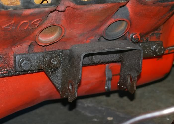

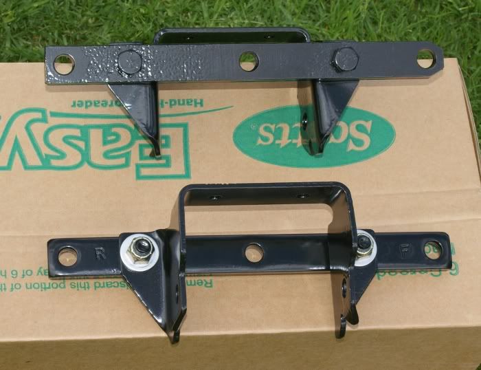

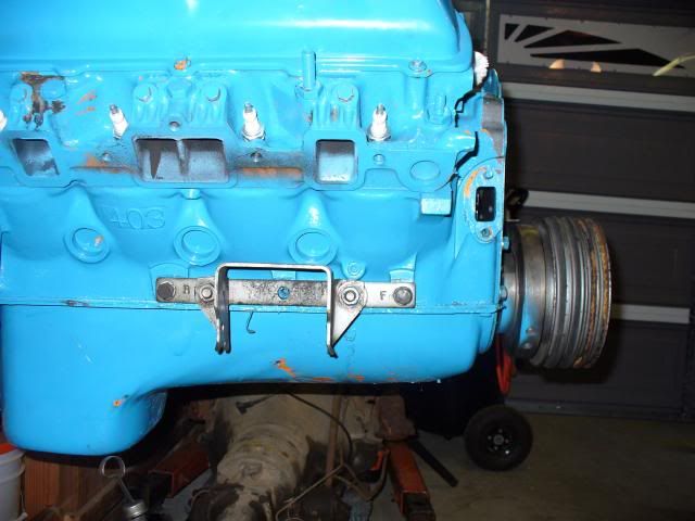

I just bought a set of motor mounts from someone to mount this beast. They are the ones that bolt to the block with the bar to shift the position of the motor. Any one have any pictures to show me what bolts holts to use on the bracket, block etc?
Posts: 2884
« Reply #5 on: April 24, 2012, 05:44:09 PM »
The RH-side has Front and Rear marked on it, the LH-side has arrow-head angled front to it.
RH side:
LH-side:
1978 Firebird Formula W50 403
