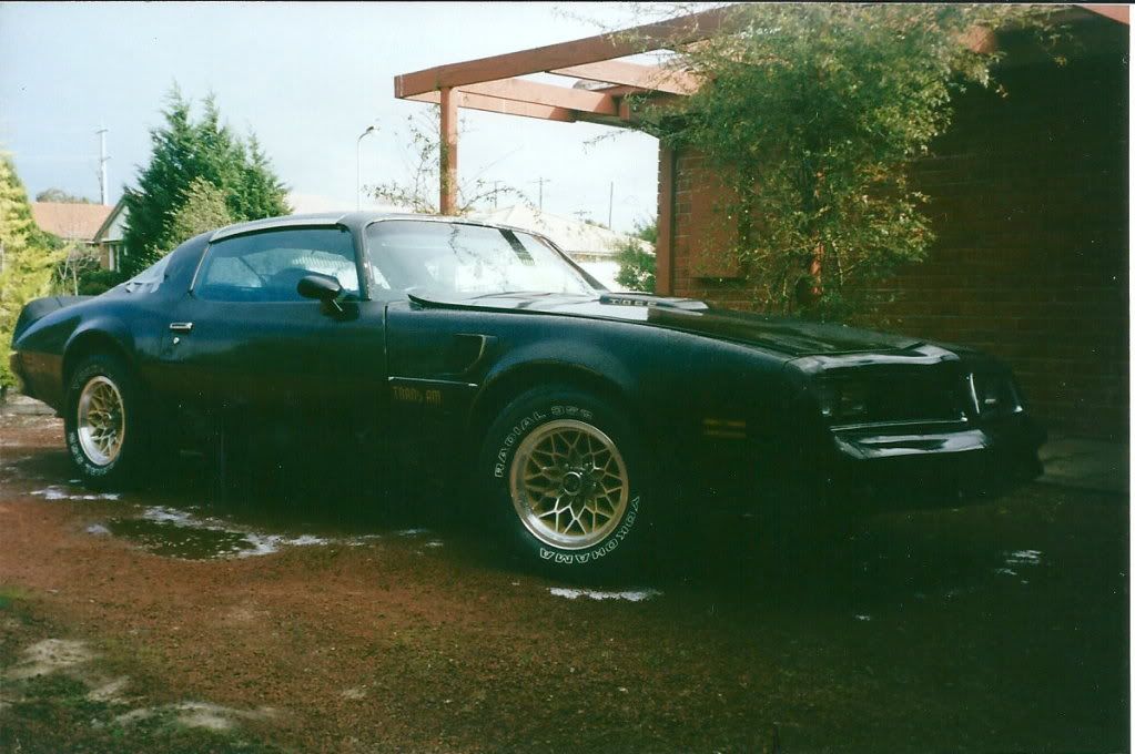

Thought you guys might like a bit of a story about my Trans Am
My name is Andrew and I am addicted to Trans Am’s
I live on the Mornington Peninsula, Victoria, Australia.
Like most of us it started in 1978 when Smokey and the Bandit came out at the movies.
As a 15 year old I couldn’t believe such a beautiful, tough car existed. So I hop on my bike and pedal to the US car dealership, about 2 hours away.
There in the lot is a Martinique Blue 1978 Trans Am. It was love at first sight. I ask the salesman how much.. $24,000.  I realise I will never be able to afford it.
My first car is a HT GTS Monaro (aussie version of 69 camaro), as close as I could afford to the Trans Am, many Monaros follow, some absolute garbage, no engines, rusted out, etc
Always looking for a Trans Am that I can afford, I test drive many but either poor right hand drive conversions, mock ups or just plain rubbish. I looked at one that was an Esprit with a Trans Am sticker on it, one had 1979 tail lights 1978 nosecone and 1973 vin number and one that only had about 5 degrees right turn as steering hit on sump pan.

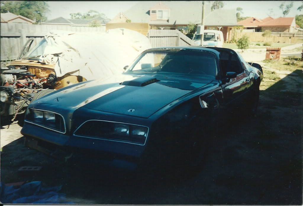

Finally in 1996 I find an advert for a 1978 Trans Am just around the corner from where I work. Left hand drive and in need of love. I go to look at it, I see the potential and I can afford it.
 I get home from work with a smile from ear to ear, my wife says what are you so happy about?, Oh no you’ve bought another car, does this one at least have an engine?

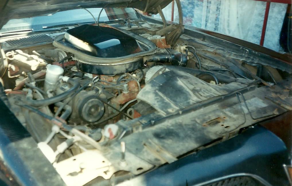

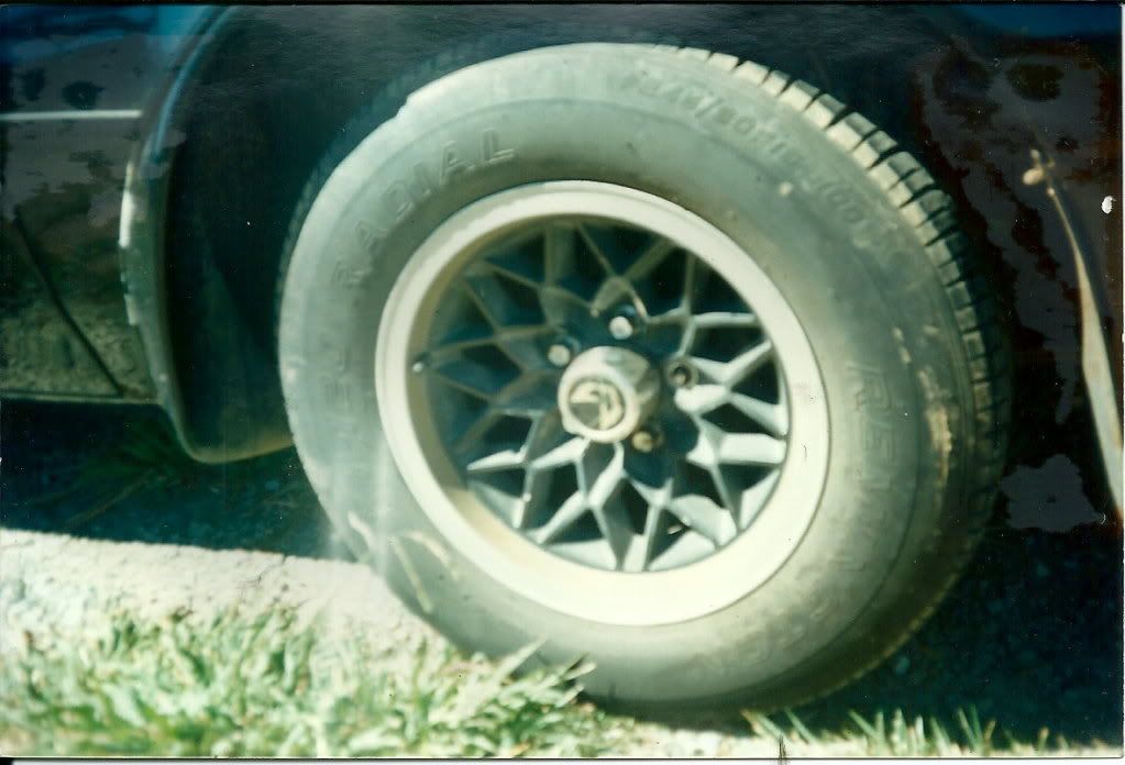

The good parts complete, running, black velour interior, eight inch snowflakes, pontiac engine(matching number), fischer T-Tops, minimal rust, power windows, AC. The bad parts every panel had minor dents and at least 5 paint jobs over original paint and decals, cracked exhaust manifolds, wheels painted black, interior worn.
Had car for about a week when a well meaning shop decodes my compliance plate for me, WS4, a base model. But the vin says 2W87Z8L****** . Now I’m nearly in tears.
I send for PHS documents. Back it comes, wow this baby is loaded Y84, WS6 which in January 1978 includes W72. I then find out that many Van Nuys cars body plates are stamped WS4.
Anyway with family commitments there isn’t much money so work is slow. I’m working up to 80 hours per week. During this time I reserve my custom number plates USA78. I perform the right hand drive conversion in the driveway ( no garage) which took 5 years. With engine and AC out I find hidden vin numbers which match and with interior out I find the build sheet which ties the crayon mark on the firewall to the body number to the vin. Then I start repairing enough to pass roadworthy inspection, I fit A body RA3 exhaust manifolds dual 2.25 inch system with hiflow cats. The cam has about 6 worn lobes so I replace it with 744 cam., new brakes, new shocks, make taillights with amber indicators., new tyres, new seatbelts etc etc
Finally make a big effort and get it registered in 2003 just in time for my 40th birthday

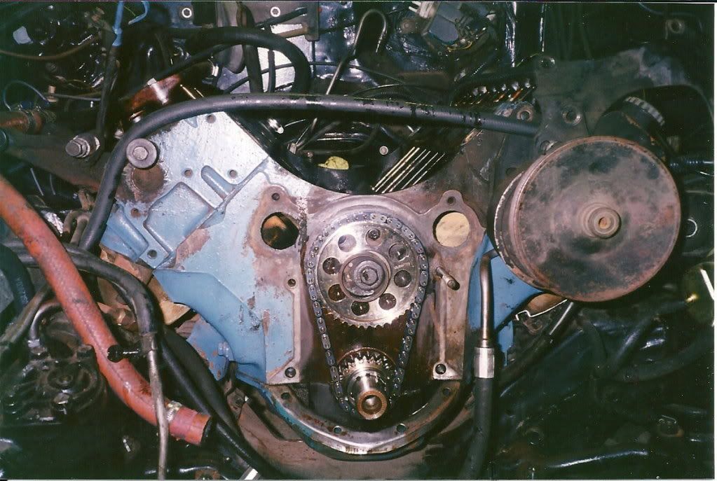

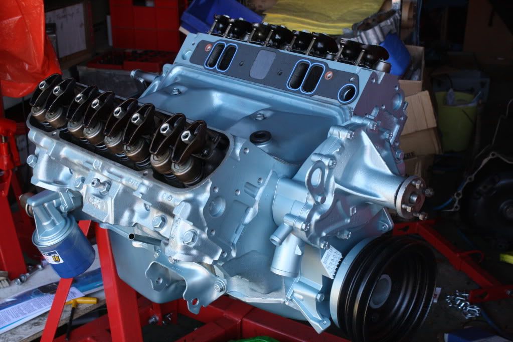

2008  money is looking a bit better I decide to completely rebuild the motor, summit 2801 cam, mill the heads 50 thou, new rings and bearings.
Never could get any decent vacuum with that cam so went back to 744. Excellent to drive but the fuel economy????

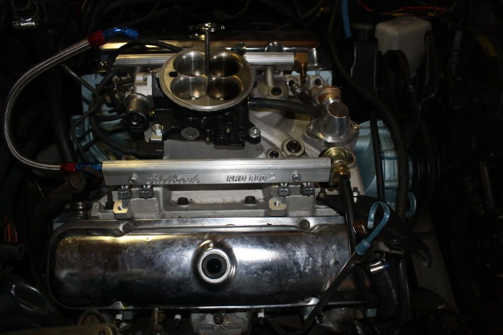

Decide to fit fuel injection,  Edelbrock Proflo2. now I have performance and economy. Setting up the injection was not easy and I’m still not 100% happy with the tune.

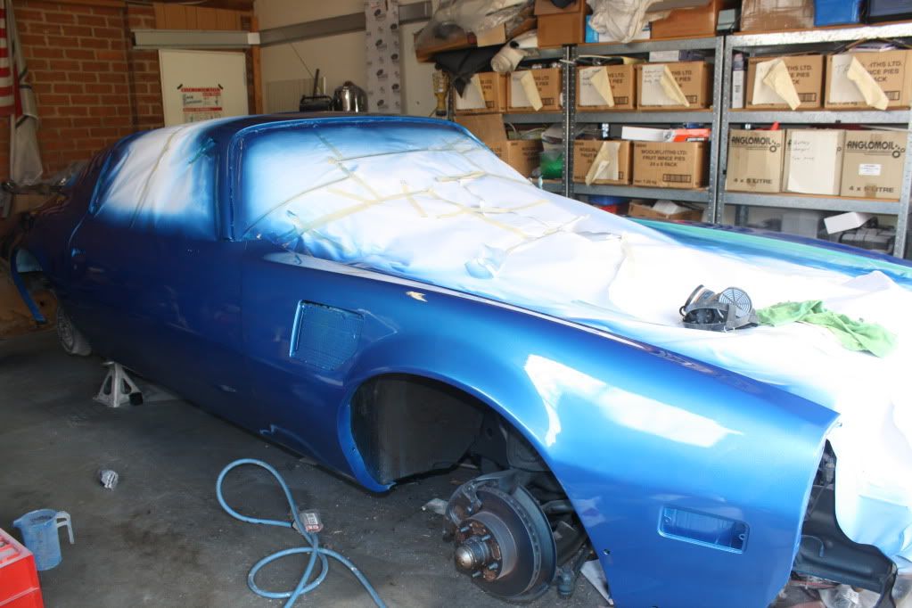

I haven't painted for about 16 years, (the gold HZ GTS in the first photo was the last one)
The paint came out reasonable, everyone that has seen it says it looks perfect but I have high standards, a big windstorm came up just as I was painting the clear, so a couple of big dust spots that I hope will buff out. Considering how much room I had to work in I am happy with the results. I don't know how they call this a double garage. 5.7m x 5.7m  (19' x 19' )
Starting to assemble the bits I have painted. Having a great time aligning the fenders.
Very dis-appointed with the bonnet (hood) so I will respray that along with the spoilers and shaker which I haven't done yet

Certainly came out nice for backyard paint, nice colour choice too. Bit hard to tell, is the fuel injected setup currently under that aircleaner or is that a different car in the other photos?

« Reply #8 on: April 11, 2012, 12:25:19 AM »
All of the photos are of my car and engine, the first photos are how it came home and then follow in order
Yes that is the same engine with the injection hiding under the scoop (bit of a shame you can barely see it)
The proflo2 injection uses a 4 barrel throttle body on a modified performer manifold

Got rid of that BOP 1 piece oil pan gasket
so now no oil leaks
and scratched the new paint on the nosecone in the process
one step forward one step back
