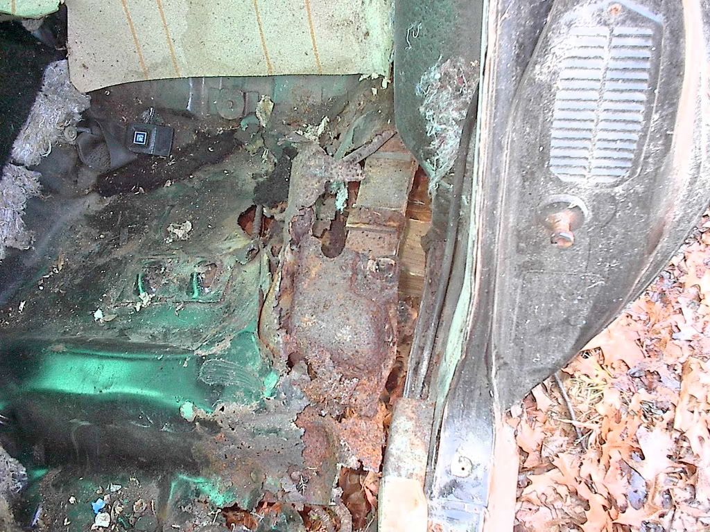

 Got a deal on a 80 T/A couple of years ago. It has a 403 that turned over when I got it. Got it from a kid that could not deal with the amount of rust repair it needs. Some would part it out. That is what I  got it for, But I hate to kill a bird. Then I ran across a shell on e-pay.  The owner prior to the kid drove the car until the gas or brake lines rusted through.  It has a Cincinatti air port parking decal on it so I guess it saw lots of salt. It is rusted through from the toe boards back. ALL 4 Spring points where protruding through the body!
Here it is when I got it home.
This is drivers side back seat area.
Rear trunk drivers side.

So I plan to cut it across at the toe boards and at the rear window posts and replace the bottom and rear of the shell.   Shocked  Thus saving an old bird.
 Suggestions as I go are welcome, this is a major project and I am not a pro.  Confused

I don't mean to be negative, but that car isn't even a parts car.  Save yourself the money and aggrivation and get a better bird.

Good luck.......but unless you're experienced and have nothing else to do, that project is not going to be at the Nats this year.
Keep as much of the original 80 shell that you can, take lots of measurements and use light guage tubing tacked into the shell where required (before you cut the shell up) to give reference points for the new parts to welded in.
Get a Fisher Body Manual for the late 2nd gens to help out with info.

Have a fisher body manual. and the new used rear shell will bolt to the back of the front frame. I am not building a show car but when done it will be a solid driver. 14hr to this point with my brother doing most of the work under my supervision. Weather got rainy, cold and windy again so stopped until fair weather returns.
