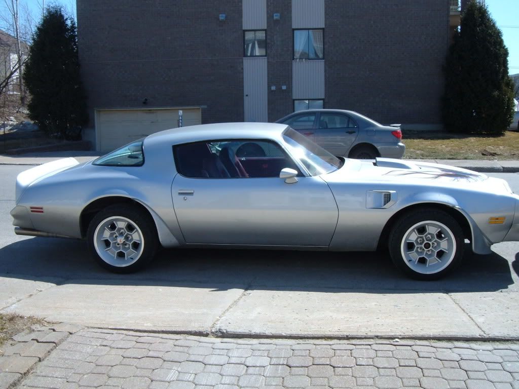

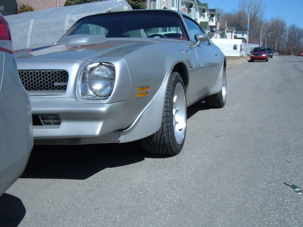

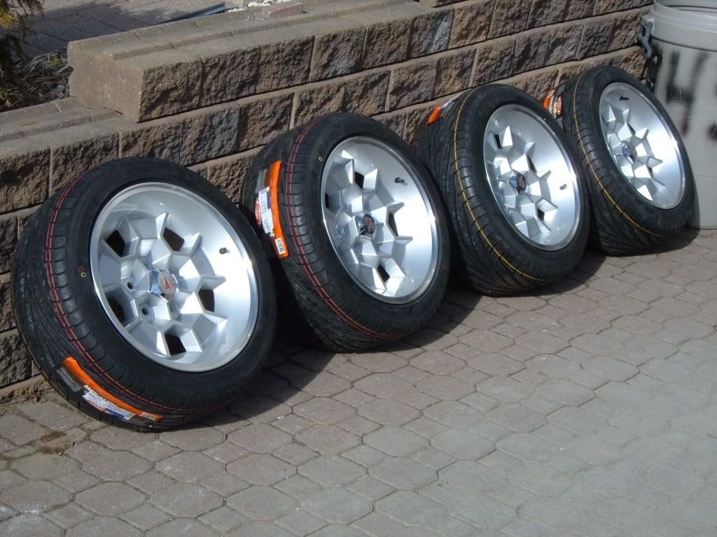

yah, quite a few of us purchased them beauties.
I went with 245-45-17 all around. You can go pretty wide with these puppies if you want:
If you need more angles let me know.
