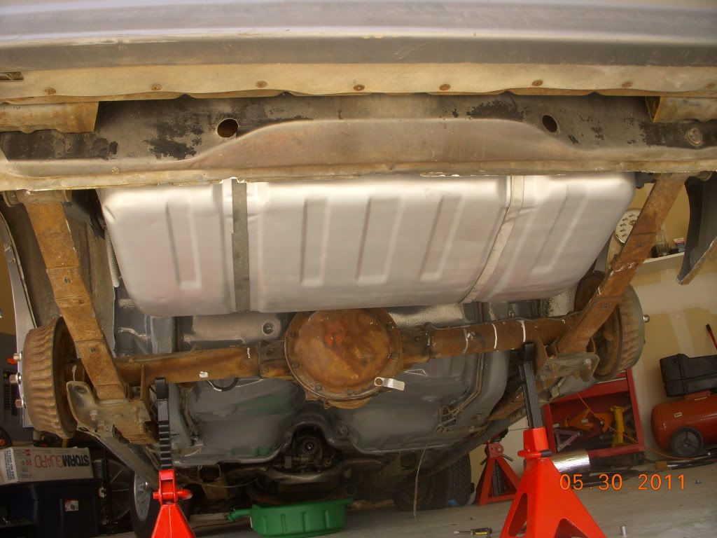

I bought my 78 TA in Jan and decided to start with the back of the car and move forward.  I removed the tank for inspection and paint the floor pan.  Also found the build sheet on top of the tank.
I noticed some of the factory welds at the floor pan and rear frame where less then desirable so I add a few stitches.
This is the day I brought it home.

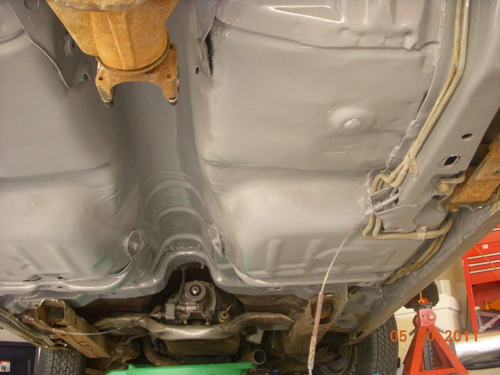

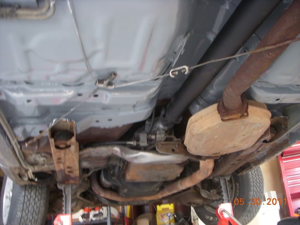

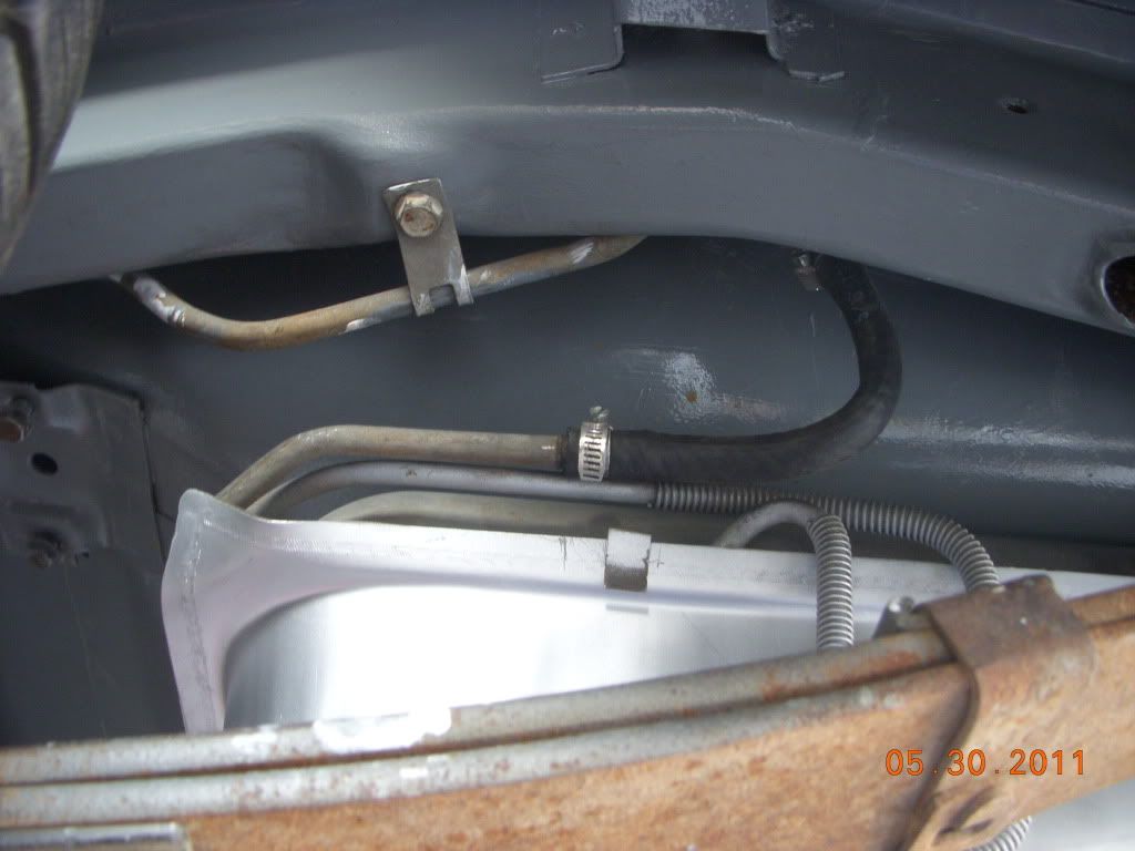

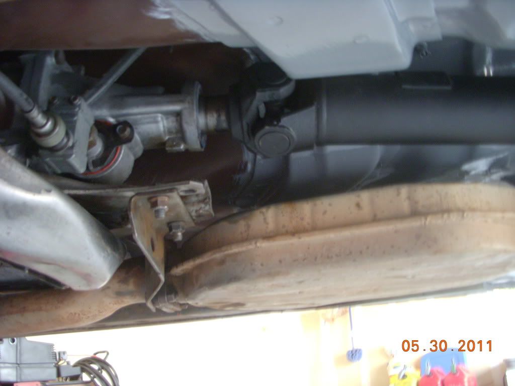

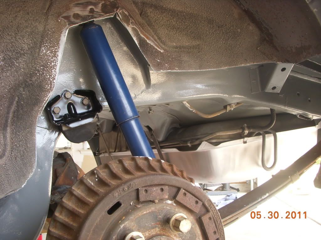

Been slow going last few months.  Here's some updates.  I've welded in the floor pan replacements both inside and out.  Here's some pics of roughing in the body work to smooth the weld seams under the car.  Still have some sanding to finish before paint.
Here's some shots of the inside floor pan painted.  Not too concerned withe looks since it'll be under carpet and all.

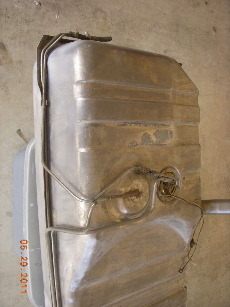

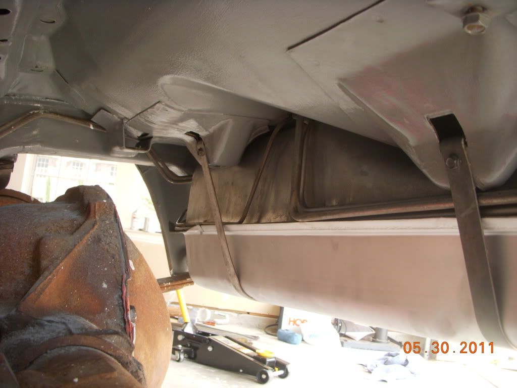

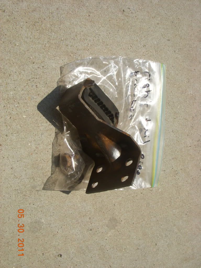

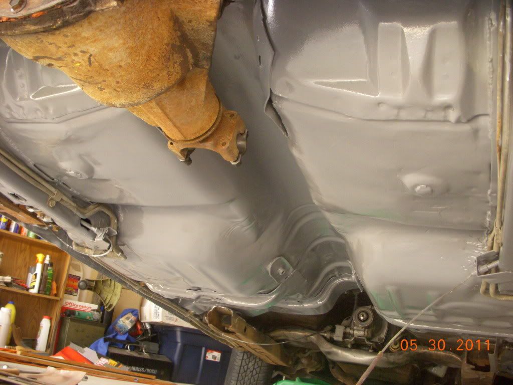

I got tired of pushing this thing around so I decided to reassemble.  I need to get it outside with the garden hose to find any leaks before I install new carper and interior pieces. No better way to spend Memorial day right?
I replaced the original hose on top of the tank.  It was as hard as a brick. Still had GM codes on it.
slid the cleaned tank in place went in just like it belonged there.
bolted on the  shocks and ruber bouncer.
When I sort out the exhaust I'll reuse the original hangers they held up well over the years.
I used a lap joint when I replaced the pans so I welded the inside and outside of the joint.  Then I used body filler to smooth the exterior floor pan to hide the joint.  I sanded and painted the pans up to the seam under the front seats.  When I pull the front sub frame for cleaning and painting I’ll finish painting the floor then.
I installed the front half of the exhaust so I didn’t go deaf running the car.  Also cleaned and hooked up the e-brake cable, painted and installed the drive shaft. I attached all the fuel lines back in their factory locations.  This thing went together so easy.
I added a gallon of gas and primed the carb.  Hit the key and the car would only run on the fuel I primed it with.  OK…added more gas to the tank thinking 1 gal may not be enough….no deal.  Again, car would only run if I primed the carb.  Check the squirters and no fuel was getting to the carb.  There’s 4 gallons in the tank and a new fuel pump installed by previous owner.  So I slide under the corner and look at the fuel line I installed.  DAAHHHH crimped fuel line!  What a dumb ass.  It was 9 at night and I had to get up for work in 5 hrs so I called it a day and went in for the night with a big grin on my face cause I at least got to hear this sucker run for a few short bursts.

Thanks, turned out the rubber fuel line was not kinked.  When I had the tank out for painting and the fuel pickup tube on the shelf a dirt dobber musta plugged to line.  I dropped the tank removed the pick up tube and shot the dobber nest out like a snot rocket.  Reinstalled and she started and ran just fine.  Guess the water hose test will have to wait another day.  I did notice the negative battery cable was getting hot when hooked up WTF man! not another problem.
You will want to get some anti-squeek pads under the tank. I used a roll or 2" rubber that I had laying around that worked just fine.
Your work looks great. Keep it up.
