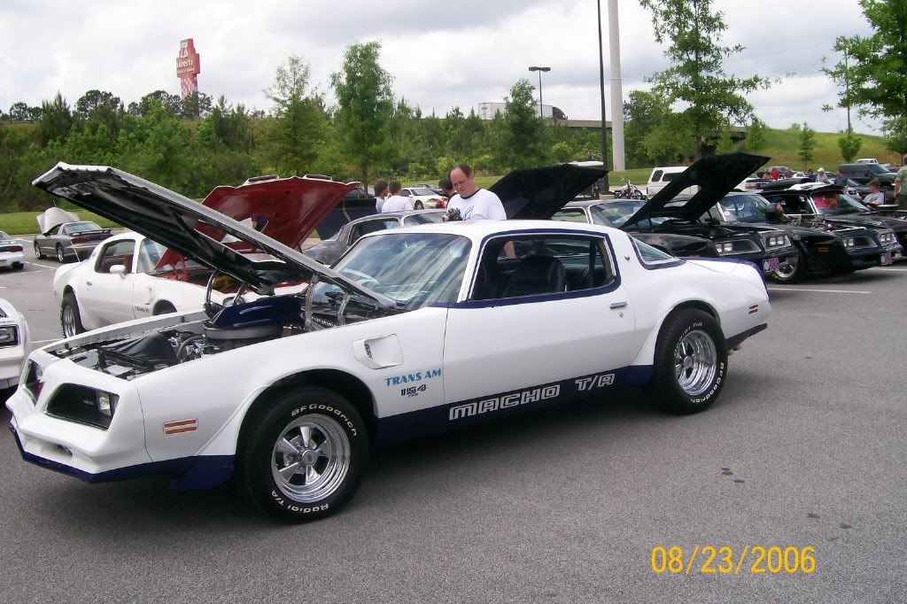

I have 15x8 in the front and 15x8 with reverse offset on the rear.

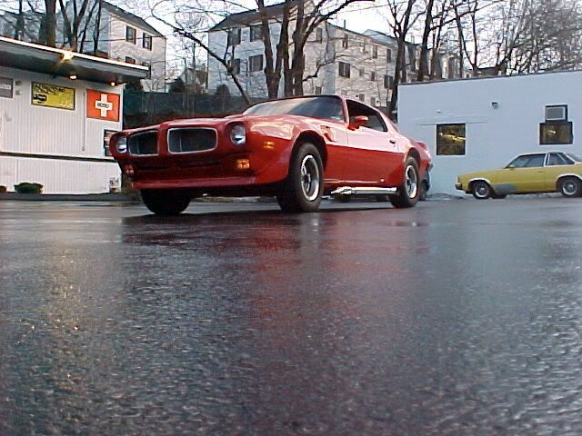

On my 70 I had 255 60 15's with 4.5" backspacing Rally IIs and they hit the inner fenderwells in the front toward the outside with stock suspension. It was worse after I lowered the car. You can see in the pic below how they're out toward the edge of the wheelwell and make the car "taller"
