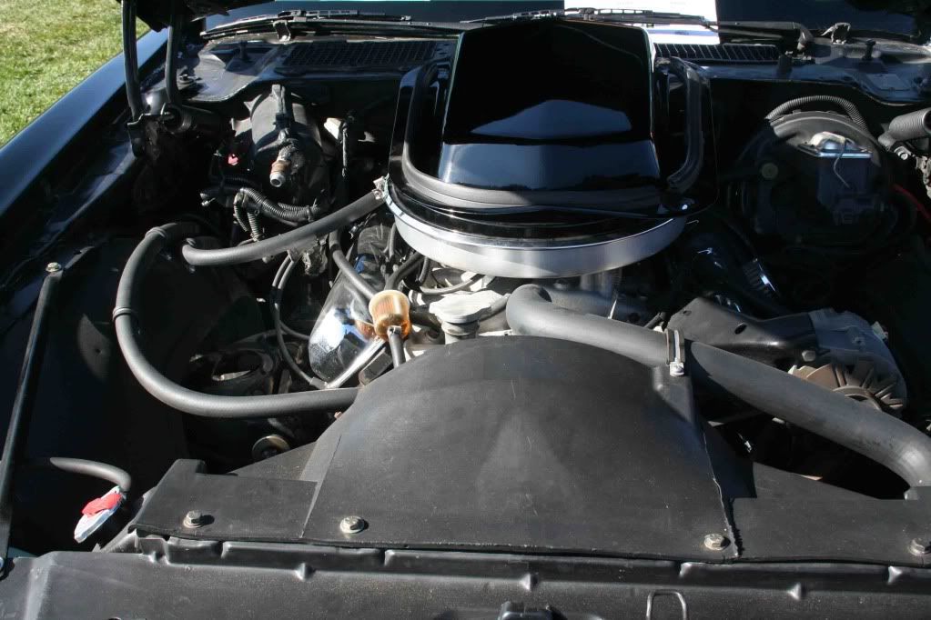

BBATCAR
  • Posts: 286
  • I'd rather be cruisin'
      • http://s250.photobucket.com/albums/gg268/BBATCAR/
Re: Cheap way to mount a shaker?
« Reply #11 on: October 23, 2009, 03:09:29 PM »
Sounds interesting. Got any pics? I have an air cleaner from a '77 Delta 88 (same exact diameter as a stock shake base!)that I can cut up. I was actually thinking of doing this a long time ago, but using a drop base from a parts store chrome 14'' setup as the bottom part instead of the bundt pan.
Sorry it took so long , here is the pic but you cannot see the spacer between the bell shape and outer pan
